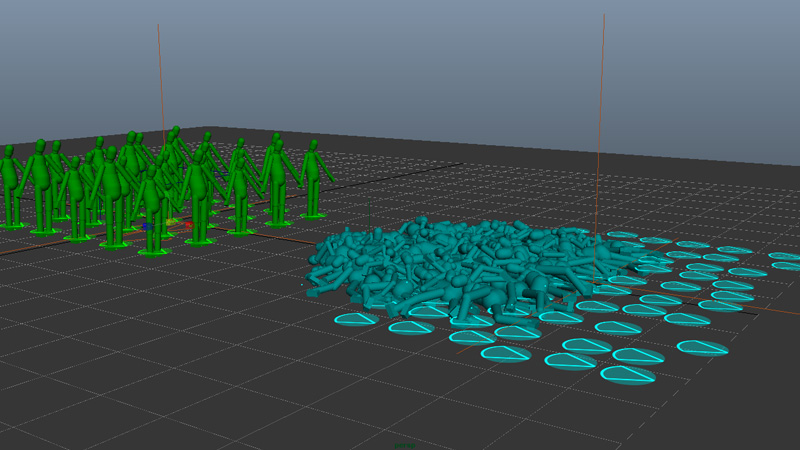

Follow the Setup and Physicalize Dead Entities parts of the Walking on Dead Entities with AdaptGround Behavior tutorial.

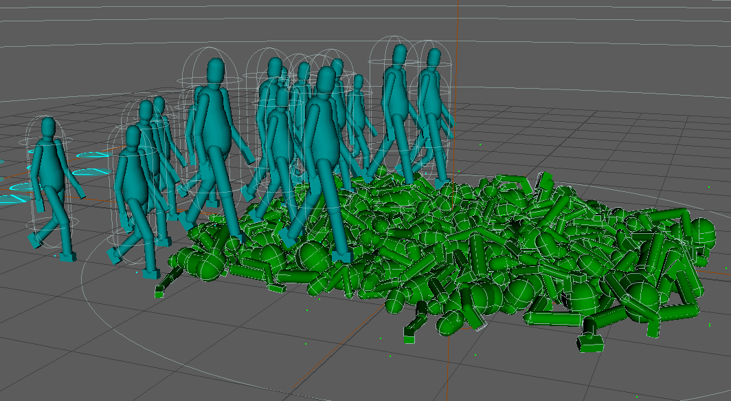

You should obtain a scene similar to the image below

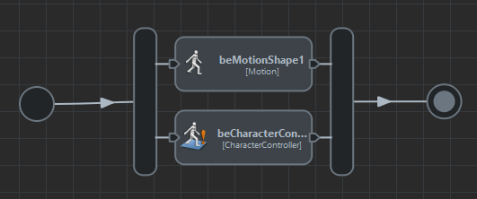

Once the dead Entities have been added to the Golaem physics world, it is possible to use a CharacterController to walk on them. Here the CharacterController behavior is played in parrallel with a Motion Behavior playing a simple walk motion:

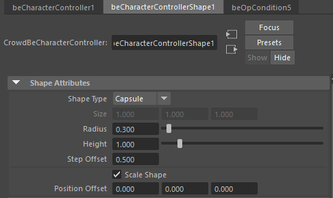

Then configure the shape attributes of the CharacterController. This shapes affects how the collision between your character and the other physicalized characters will be detected.

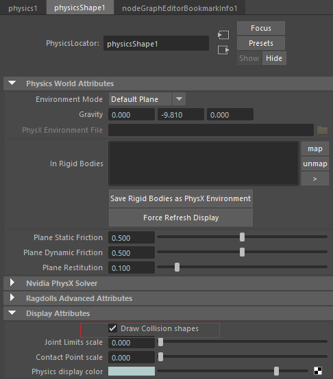

To check what the shape looks like, you can enable the Physical Shapes display on the physics locator (then rewind simulation and play)
The character controller will automatically move your character up to prevent all characters collision shapes from interpenetrating.
You can take a look at other parameters on the CharacterController behavior to customize the effect further.
