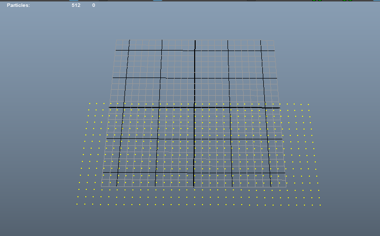

Using Maya particles to place your Entities
Golaem entities to be placed on it, here are several ways to do so.

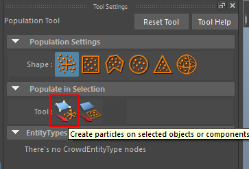

CREATE A POPULATION TOOL ON THE PARTICLES
1. Select the particles in component mode.
2. Click the Population Tool icon in the  Golaem shelf  and select the component mode .
3. Your population tool is now placed directly on the particles.
4. Create an Entity Type  and load your Golaem Character in it (if you don't now how to do so please refer to the Quickstart Tutorial), set a rendering type for your Entity Type.

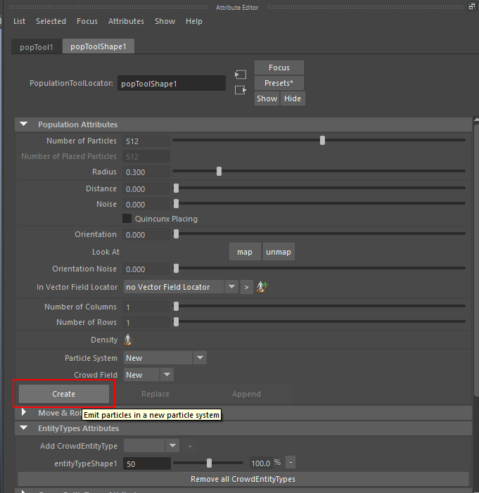

5. Open the Population Tool attributes and map the Entity Type in it.
6. Click the Create button.

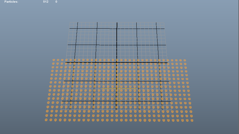

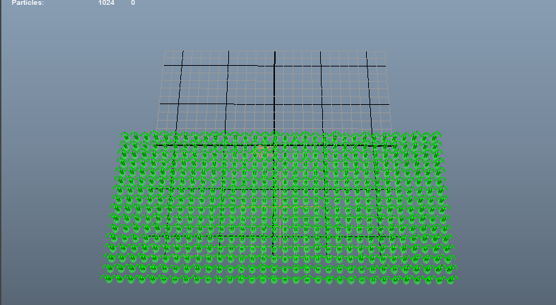

7. A Crowd Field is created with a new particle field generated with all the Golaem PP attributes required for simulation.
8. Play the simulation to see the entities.

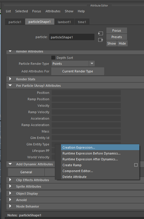

1. Select your Particle Field and open the attribute editor.

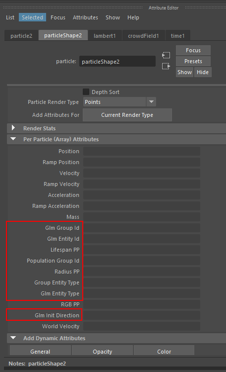

2. Go inside the Per Particle Attributes section. Maya particles are generated with some PP attributes by default, but Golaem needs some more PP attributes in order to generate entities on it correctly. To create new Per Particle Attributes on your particles please refer to the Per Particle Handling documentation page.
Here is a list of Per Particles Attributes mandatory for Golaem simulation:
glmEntityId unique ID of the entity generated on particle
glmEntityType Entity Type of the entity generated on particle

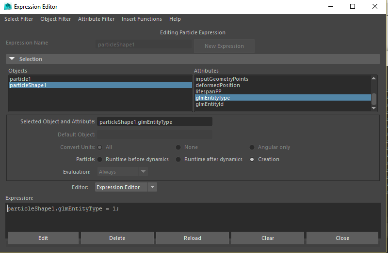

3. Go inside the PP attributes section and right click the PP attribute glmEntityType to create an expression.
5. Set the values so the Entity Types mapped are valid.

Several Per Particle Attributes can be created and/or defined to control the simulation more precisely:
glmInitDirection Set the initial direction of the particle if not defined the entities will be facing X by default.
groupEntityType Group Entity Type mapped to the entities, mandatory when using Group Entity Type.
populationGroupId ID of the population Group mapped to the entity, mandatory when using Group Entity Type
