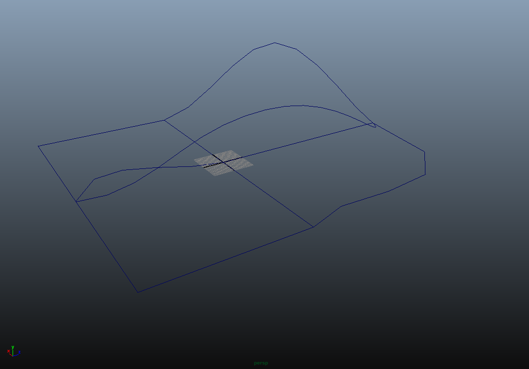

In this example, we use a few curves to define some roads. As the crossings are detected where curves are connected, we will make their ends match by snapping them to each other (you could use the snap vertex tool). If you want to skip this part, a traffic01.ma scene is available in the Character Pack for this purpose.

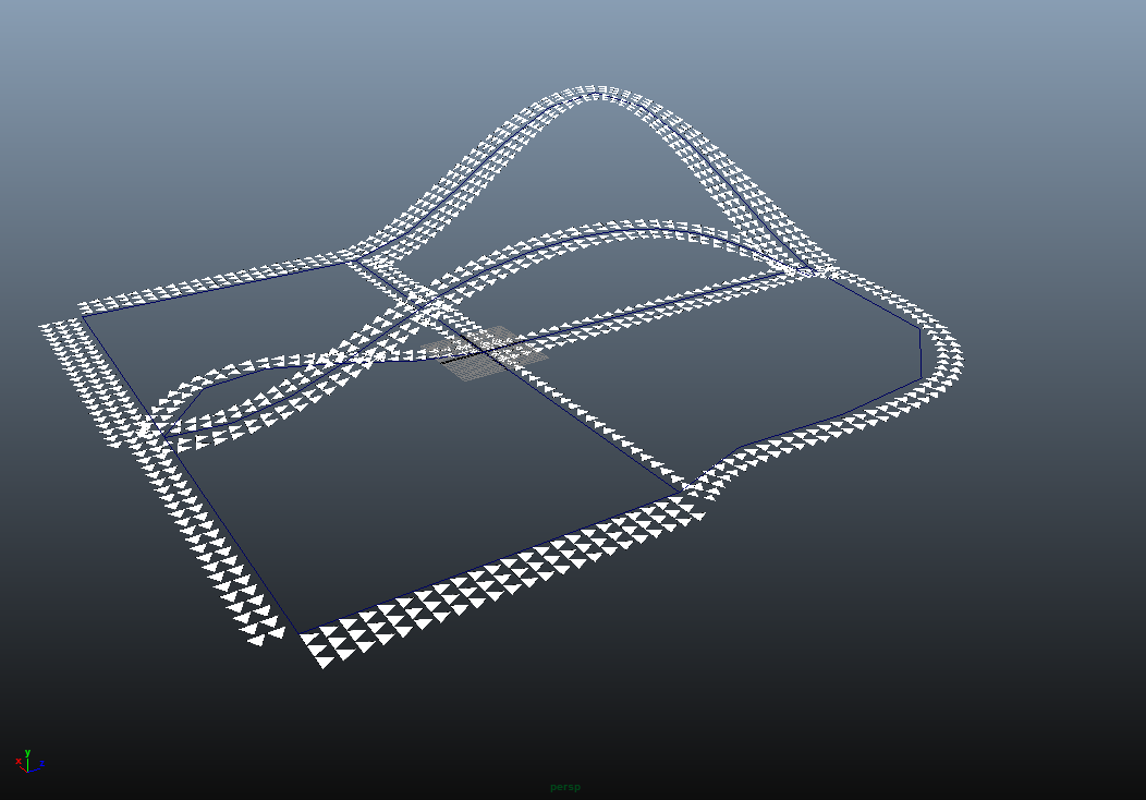

Curves representing the road graph
The graph can be either 2D or 3D, but keep in mind that the cars won't be able to climb totally vertical slopes (some simulation parts rely on up-projected coordinates). Sharp turning curves could also produce near impossible lanes, especially with high number of lanes per curve.

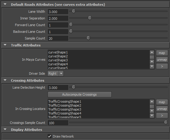

Traffic Locator Attributes
Create a Traffic Locator from the Golaem menu. You can configure default values for the curves attributes here : lane width, each side lane count, inner separation and sample count (more samples gives smoother orientations on lanes).
Select the curves, then the traffic locator, and map them via Traffic Attributes. Once bound to the Traffic Locator, Maya curves acquire new extra attributes.

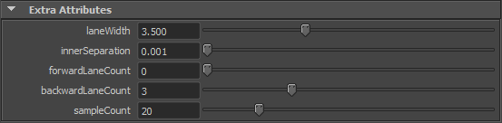

The lane width, count, separation and sample count can be set per curve from their Extra Attributes. The default values found in the Traffic Locator are only used at curves first binding time. The meaning of forward / backward refers to the order in which the curve has been drawn, but the simplest way is to play with the parameters, as their effect is directly visible. Depending on your location, you may use a left or right driver side.
Curves Extra Attributes added by Traffic Locator
You now have a road graph to map entities to :
Curves bound to Traffic Locator show lanes
Once the main traffic graph is correct, crossings can be generated.
The Traffic Locator "Autocompute Crossings" button process iterates over each road end, and check if a crossing already exists at this location (the crossing radius must include the lane end). If there is no crossing matching this criterion, one will be created.
The lanes are detected only if their vertical distance to crossing does not exceed the "lane detection height", allowing to have two crossings at different heights of the same position. Crossings are parented to the traffic locator for easier access.

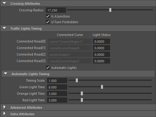

Crossing Attributes
The lights can either be automatic, or user can get control over it.
If automatic, the lights will be paired, preferably if they are aligned, and for each pair at once the lights will go from green, to orange, then red, according to timings configuration (then next pair is picked and it continues).
Crossing can also behave as a junction, with all the lights constantly green (useful to make split or merge branching crossing).
Finally, a fine control can be achieved over the lights status of each lane by key-framing Light Status values, using 0 (or less) for red and 1 (or more) for green. If so, please uncheck "Automatic Lights" to avoid conflicts.
One can also prevent the cars to make U turns on some crossings. By default, the cars may make U turn if this is the only possible solution to get out of the crossing, or if a planned path found it as the shortest path.

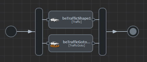

Once this is done, open the Behavior Editor using the Behavior Editor icon, then double-click on the EntityType, and add a Traffic Behavior to the behavior graph, then a TrafficGoto Behavior on top of it. It will build a Parallel Operator holding these two behaviors.
BeTraffic and BeTrafficGoto added to the behavior graph of the Entity

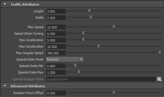

You can configure some properties of the car in the BeTraffic attributes: length & width in meters, maximum speed and speed when turning, maximum acceleration and deceleration. Some standard values would be around 6 meters length, 2.x meters width, acceleration and deceleration around 5 or 10 m.s-2. You can also limit the rotation speed of the cars via a maximum angular speed (in degrees per second). A ratio can be set for speeds to randomize the speeds and accelerations in the given range (default is a random ratio between 0.8 and 1.2).
BeTraffic Attributes
You may have built a vehicle asset with the "pelvis" skeleton bone not centered on your meshes, because you want it to rotate around its location. If so, you will need to adjust the advanced attribute "rotation pivot offset".
By default, the length of the car spans evenly in front and back directions of the car, from the pelvis. If you have a root near the back of the vehicle, you will need to raise this value above 0, to the distance between the car center and the position of pelvis. If the root is near the front of the car, do the same with negative values. You can have a look at the "troubleshooting" section below, to view the actual size of the vehicle in the simulation, and to be able to adjust it.

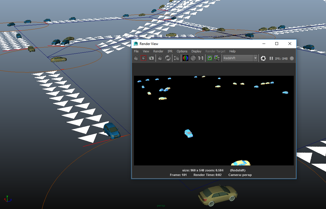

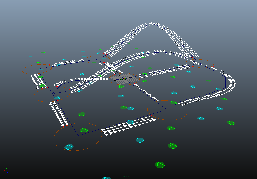

Whereas the cars placement can be achieved by any Population Tool way, it is better to select the traffic curves, then create a population tool, and use the populate on curves method. Thus the population tool will read the curves traffic attributes defining the lanes and direction, to place and span the cars in a suitable way. In all the cases, the cars will be bound to the closest lane they can find in the traffic as soon as we add a BeTraffic.
Same scene after adding a Population Tool (two cars entity types here)
Running the simulation at this time should now produce a good looking traffic :
Traffic Simulation (Population Tool hidden)

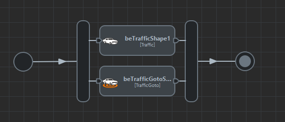

Open the Behavior Editor, and select the TrafficGoto Behavior.
a Traffic Behavior and TrafficGoto Behavior running in parallel

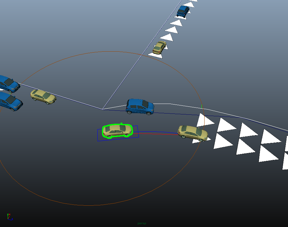

To be able to easily pick an entity, you must have declared a decent radius in population tool. You can also have a look at your EntityType >EntityTypeAttributes>RadiusToHeighRatio to modify the picking cylinder to pick entities more easily (usually, for a car, a radius of 2 and a radiusToHeightRatio of 0.5 is fine). If entity picking is an issue, you can check the cylinder in EntityType > DisplayAttributes and set it as Cylinder, you will see the pickable volume. Finally you need to be in object mode (F8) for picking to work while in simulation.
In the CrowdManager, under the section "Viewport Visual Feedback Attributes", you will find three options to display information about the picked entity :
Traffic specific attributes in Viewport Visual Feedback Attributes
On the Traffic Locator node, there is a "draw network" option under "Display Attributes". This will display some red lines, showing all the virtual lanes produced from the lanes configuration. This can helps troubleshooting where some additional lane sampling is required.
*Traffic debug information, when picking an entity during simulation*
