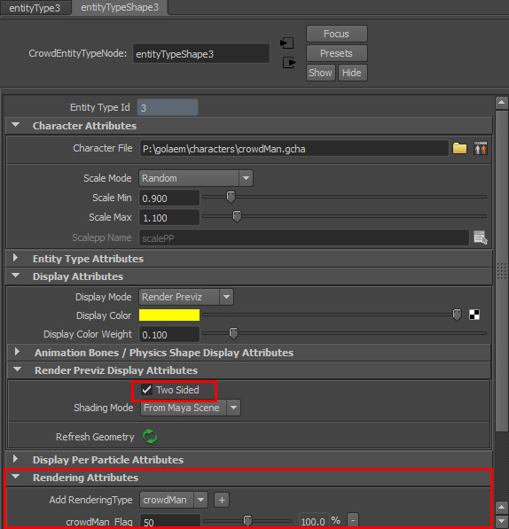

1. Create a new EntityType for people with flags, browse to find the Character Pack CrowdMan .gcha file.
2. In the Attribute Editor, find the Rendering Attributes panel.

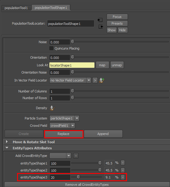

3. Place a few of these people as usual using the Population Tool . If you are dealing with an existing scene, add the created type in the EntityType in the EntityType Attributes list of your Population Tool, modify the weight if needed, and click Replace.
4. Play the simulation. You should now notice a few people holding flags in your crowd.

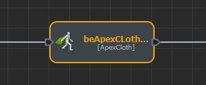

5.Let's add cloth simulation on top of the flag. Open the Behavior editor and drag and drop an Apex Cloth Behavior .

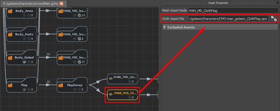

In this tutorial, we will use the .apx file provided with the Golaem Character Pack. For your reference, the link between .apx files and a mesh is specified in the Golaem Character Maker.
Apex setup for the flag on the CrowdMan character. This is already done in the provided characters, the image is just here as an illustration, for your reference.

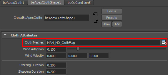

Click on the helper at the right-hand side of the Cloth Meshes attribute of the Apex Behavior. Select the MAN_MD_ClothFlag to specify that this behavior will control the cloth simulation on this mesh.

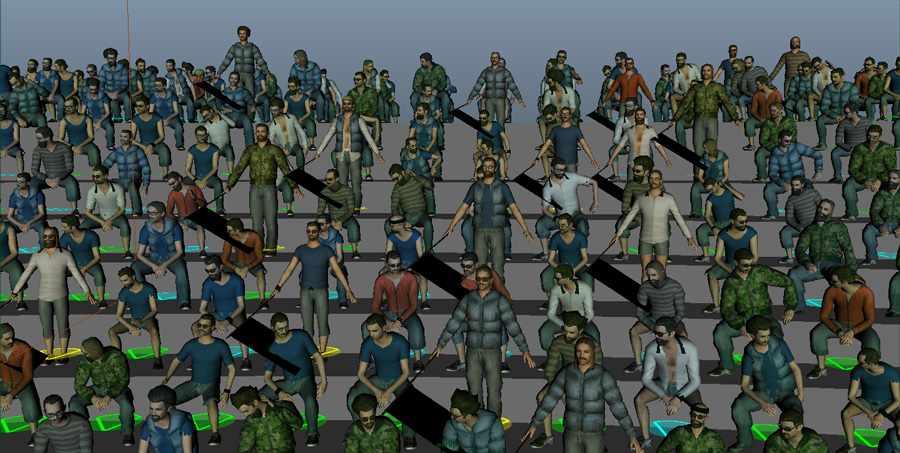

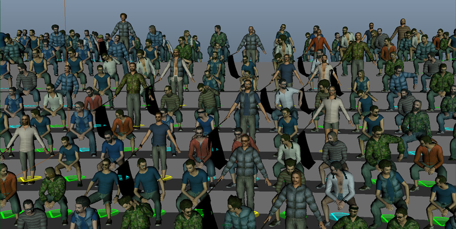

6. Play the simulation. There should be cloth simulation on the flag, however it's just falling because of gravity.

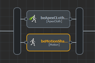

7. Now let's wave this flag! Drag and drop a Motion Behavior on top of the Apex Behavior to create a Parallel Operator  containing both.

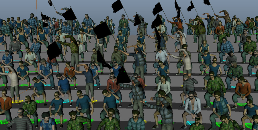

8. Play the simulation. Now the characters are waving their arms and the cloth simulation follows their motions.

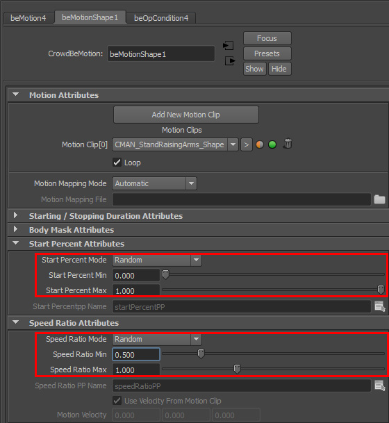

9. Notice that all the characters are synchronized. Let's modify a few parameters in the Motion Behavior to randomize the animation start percent timing and speed.

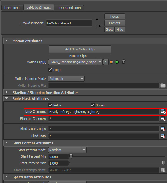

10. As the Raising Arm motion is made for concert crowd characters, the characters are also waving the left arm. We can cancel that by using the Body Masks on the Motion Behavior so that it does not play any motion on the left arm.
Open the Body Mask Attributes panel, use the helper at the right-hand side of the Limb Channels and select everything except the LeftArm.

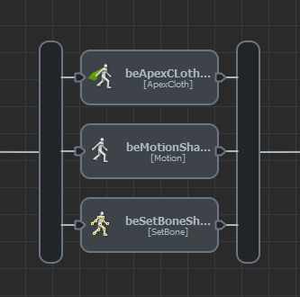

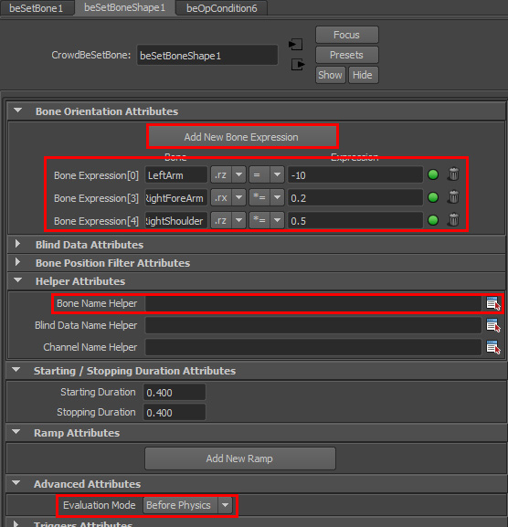

12. We will fix these problems with a SetBone Behavior which enables to procedurally modify the animation of the characters.
Drag and drop a SetBone Behavior in the Parallel Operator.
Then click on the "Add New Bone Expression" button to add the following bone expressions. You can use the Bone Name helper below to inspect the character bone names and get a name ready to be copy/pasted in your expression.
Pay attention to channel (.rz or .rx) as well as the operator ( = or *= )
Caution:
Do not forget to set the Evaluation Mode to "Before Physics" or your cloth simulation will not match the results of the SetBone Behavior
The SetBone behavior will be doing the following
Note that these values were found by trial and error, do not hesitate to experiment with them

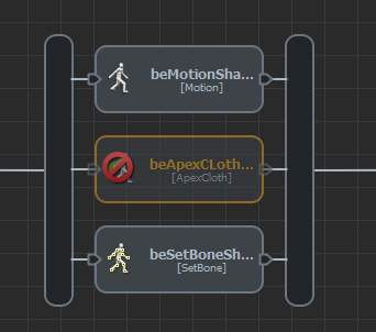

If you have lots of flags in your stadium, you can simply disable the Apex Behavior to iterate faster on your scene and activate it again before the final simulation export. Just click on the behavior icon to change it to a "disabled" icon.
