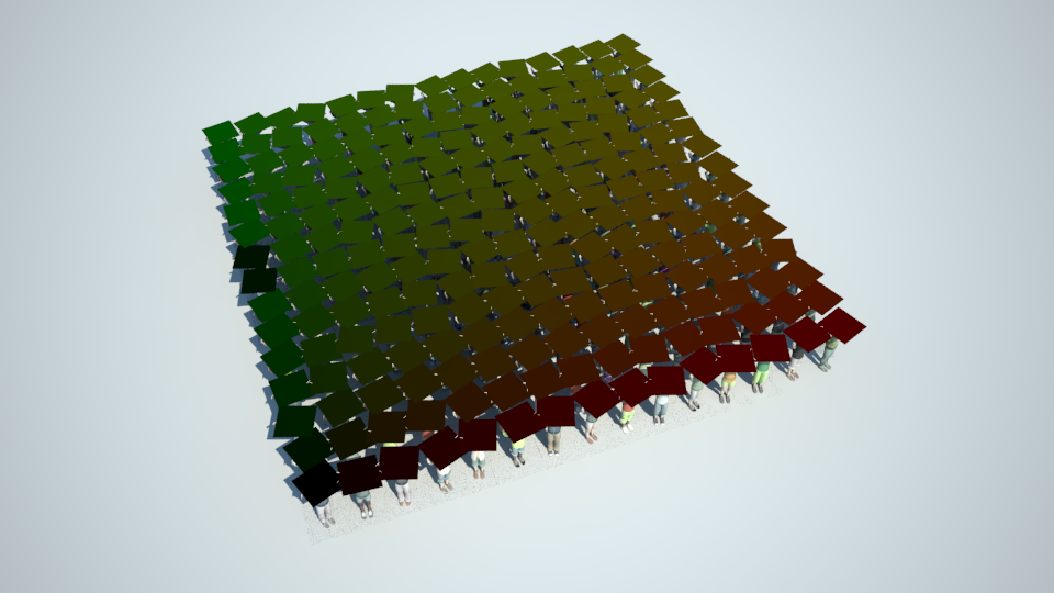

Here is how to add a general texture on the multiples signboards to form a picture.

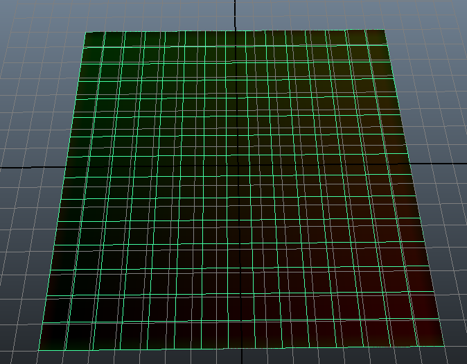

1. Create a basic geometry to generate your crowds on. Assuming that the entities are going to be generated inside each faces keep in mind the number of rows and columns.
2. Create a UV offset texture based on the length and width of your grid placement.

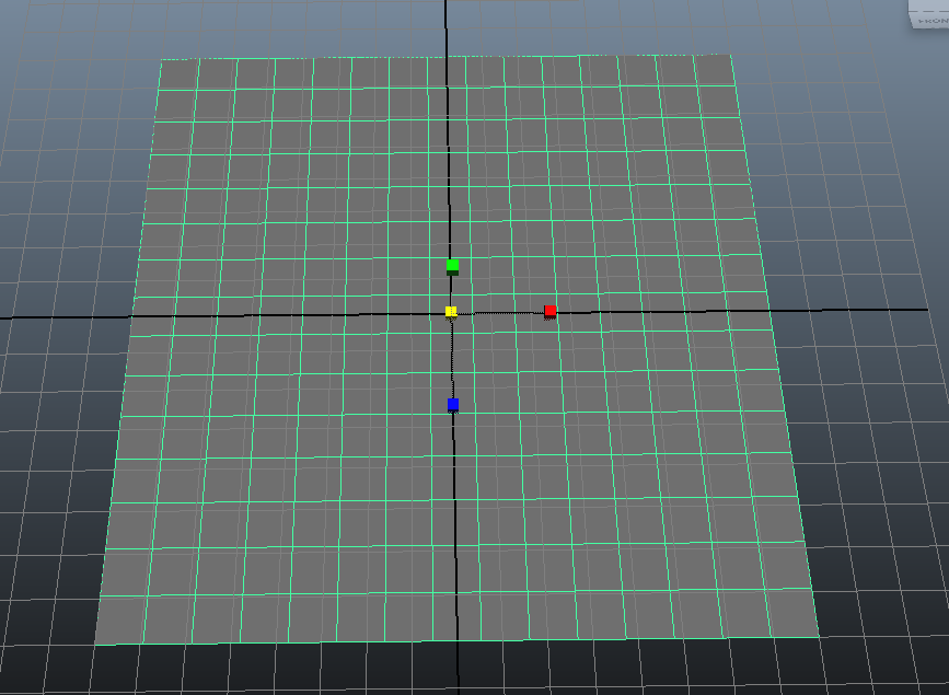

5. Place the crowd by selecting the faces and using the Population Tool
option "Create particles
on selected component"

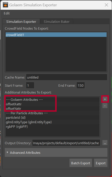

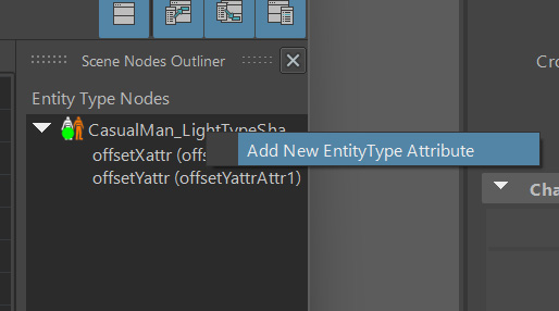

6. To store the Id of your particles to offset the picture in your signboards create 2 Golaem Attributes and name them "offsetXattr" and "offsetYattr".

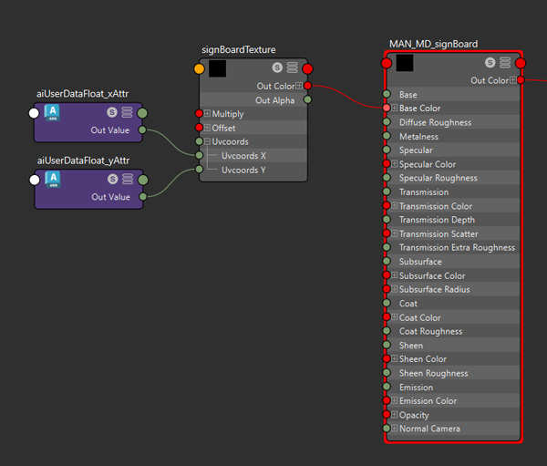

7. In your shader scene create a shader for the signboards, using a 2d file texture connected to the shader color attribute. Be sure to map this shader to your Golaem character by going in the Character Maker geometry tab and clicking the reset shader button (save your gcha).
Notice: the placement of the texture depends on the UVs of your signboard, check the UVs and adjust the placement

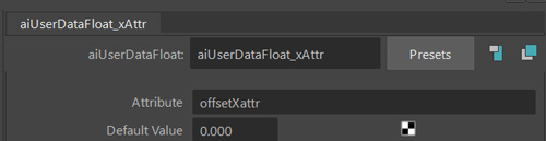

8. Add two aiUserDatafloat shaders and link them to the UV coord x & y components. This will enable you to control the U & V offset of the texture applied to a particular tile with the offsetX and offsetY attributes. See this tutorial to learn how to feed the getUserData shader with attributes values. The images in this tutorial are using Arnold, but you can easily adjust it for other renderers.

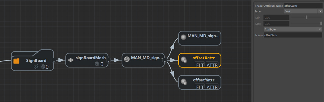

9. Go to the Geometry Tab in the Character Maker, find the shader
assigned to your signboard and add two float Shader attributes to allow
it to perform the uv offset: offsetXattr and offsetYattr. You can also
use the Reset Shaders button
after
selecting the signboard Mesh Asset node. This will add the Shader
Attribute nodes automatically. Change the sahderAttribute mode to
Attribute and fill in each attribute's name.

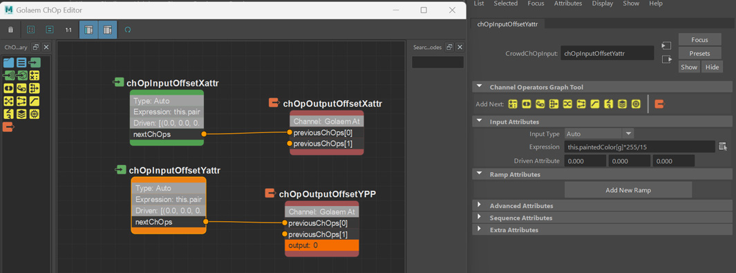

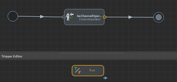

10. In the Behavior editor, drag and drop a ChannelOperator Behavior into the Behavior Graph of your entities.
11. Edit its Stop Trigger to True for your entities to pass through it and run the other behaviors we may add behind it.

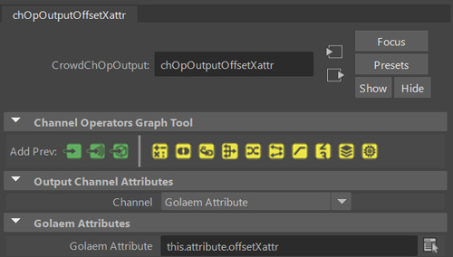

12. From the Channel Operator Attribute Editor, add two Channel Output which you will set as Golaem Attribute, for offsetXPP and offsetYPP
13. In the Channel Operator Editor, add two ChannelOperatorInput to set their value
For offsetXattr
this.paintedColor[r]*255/15
and for offsetYattr
this.paintedColor[g]*255/15
We are working on a texture of 255 different color value for each component, yet we want to divide it to the number of rows of our entity group (15 in this case)

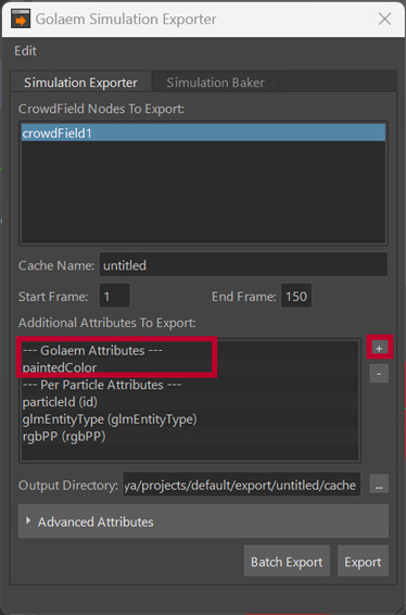

13. Edit your simulation to your will and export it using the Simulation exporter (do not forget to export your attributes by ticking the + box icon on the right side of the exporter window.
14. Render your scene!

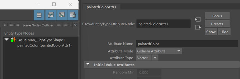

6. To store the color of the Paint Zone Trigger where your characters are created on, add a Golaem Attribute named paintedColor and set its Attribute Type to Vector.

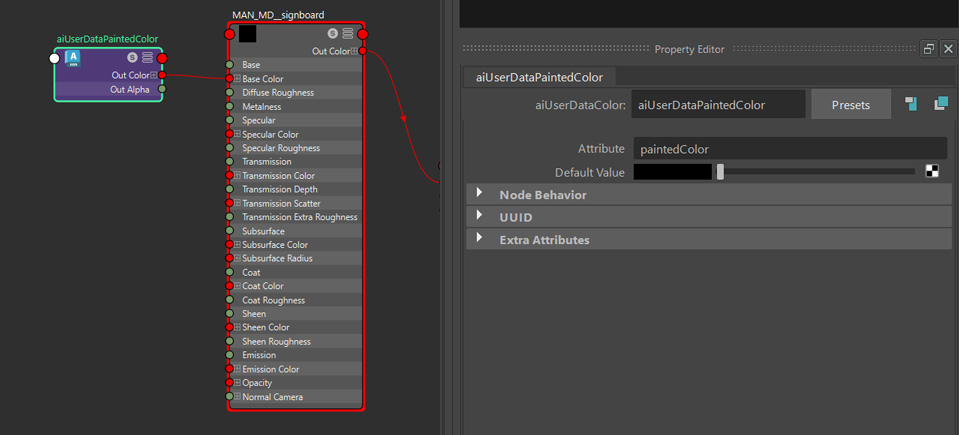

Add an aiUserDataColor to load the paintedColor attribute value we will export later.

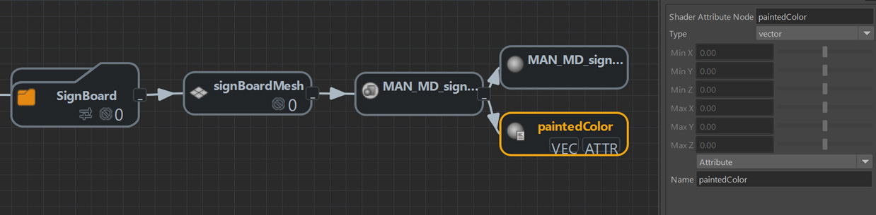

8. Go to the Geometry Tab in the Character Maker, find the shader
assigned to your signboard and add a vector Shader attributes:
paintedColor. You can also use the
after
Attribute node automatically. Set the ShaderAttribute mode to Vector /
Attribute and its value to paintedColor.

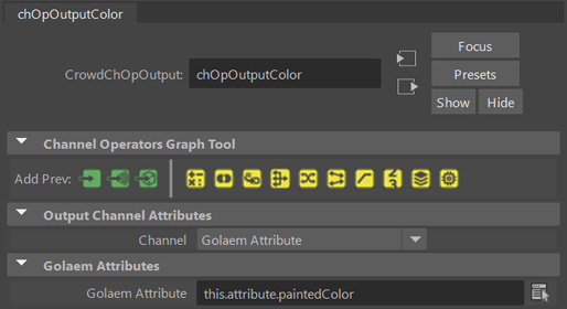

11. Create an output on our ChannelOperator Behavior and set it to Golaem Attribute this.attribute.paintedColor to write the value to the Golaem Attribute we created

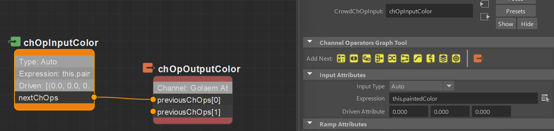

12. Open the Channel Operator Editor and feed the node we just created with a ChannelOperatorInput node with an expression set to
this.paintedColor

14. Edit your simulation to your will and export it using the Simulation exporter (do not forget to export your Golaem attribute by ticking the + box icon on the right side of the exporter window.
