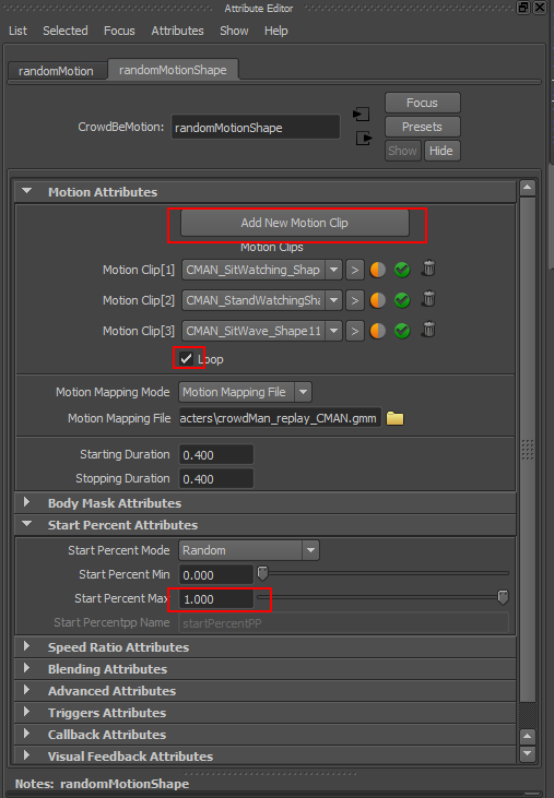

3. Select it and check your attribute editor. The main attribute is a list of motions that should be played. Just click folder icon and browse to your motions.
When adding multiple motions by clicking the "Add New Motion Clip" button, one motion will be randomly chosen each time the behavior start. It will help you to easily add animation diversity to your stadium.
If you want your motions to loop endlessly just click the Loop button. To add more animation diversity just go back to the Motion Behavior attributes and set the Start Percent Max to 1 this way your agents will play the motion at a random starting time.

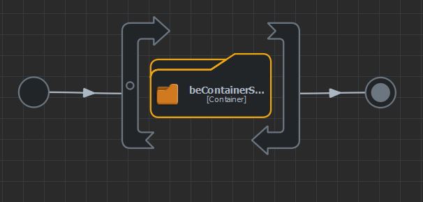

1. Open the Behavior Editor , and double click on your first EntityType.

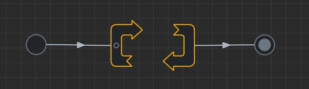

2. Then drag and drop a Loop Operator  on it as we are going to loop a group of motion clips.

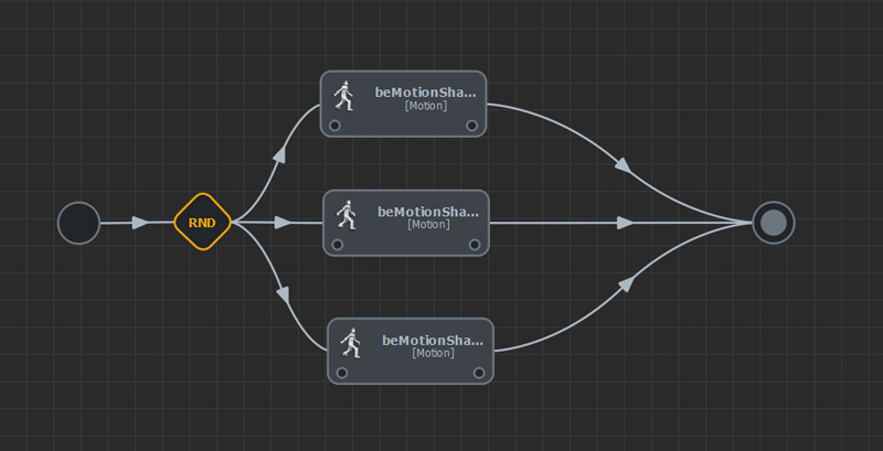

3. Now drag and drop a Behavior Container  on the Loop Operator

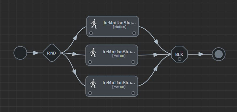

4. Go inside the Behavior Container and drop a Random Operator  on the Behavior flow. Create as many Motion Behaviors  as you need and load one motion clip per Motion Behavior. Link your Motion Behaviors right behind the Random Operator.

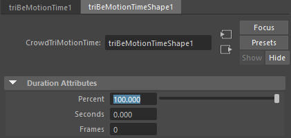

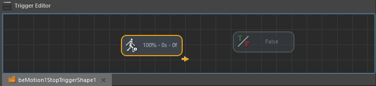

5. Double-click on the Stop Triggers of your Motion Behaviors to edit them (e.g. drag and drop a Motion Time trigger from the library and set it to 100%). Do not forget to right-click on it to set it as Root Trigger.
In this example the behavior ends after being played 100%.
Each time a stop trigger is reached, the corresponding Motion Behavior stops and the Loop operator restart the container which leads to a new random choice of Motion behavior to be started.

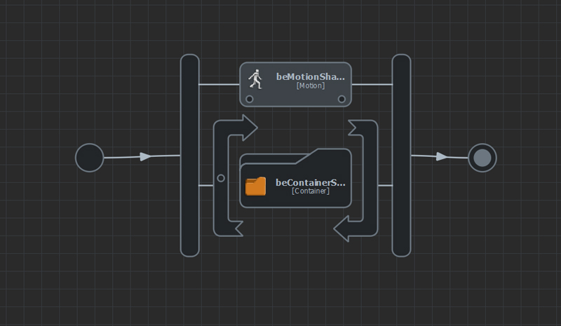

ADD A BACKGROUND MOTION
To unify the look of this crowd switching motions all time, we can add a background animation for all our entities.

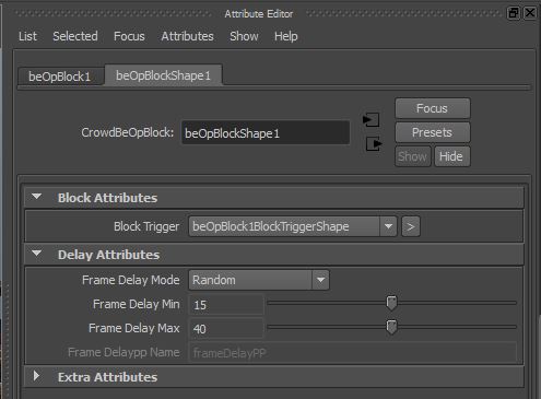

6. Drag and drop a Block Operator  at the end of this Behavior Flow.
7. And set its values to the desired amount of frames. It will delay the switch between you motions.
8. Now that the entities are returning to T-pose between each motion Behaviors it is time to add our background animation. Go back at the first level of the EntityTypeContainer and add the Motion Behavior in parallel of the container.
For the quality of the motion blending choose a motion very similar to the others. For example: if all your motions begins and ends with your character standing, choose a standing animation.

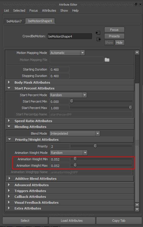

9. Go into the attributes of this Motion Behavior and edit the priority weight to a small value in order to play your motion in Background
10. Play your simulation, your agents will endlessly loop between the different motions.

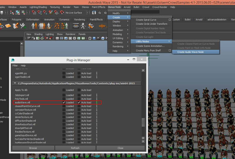

HOW TO USE A SOUND CLIP TO DRIVE THE BEHAVIOR TRIGGERS
Behavior triggers can be driven through an attribute of another object. We could use this feature to trigger a Behavior with a sound file. You can achieve this in 3 ways, using the AudioWave plug-in, SOuP’s audioToArray node and MASH’s audio node. SOuP and MASH give more precise control over the sampling frequencies of the sound file. For the scope of learning we outline the method using the audioWave plug-in, but the concept is the same with the other plug-ins. (See below for details of other plug-ins.)
1. Download and install BonusTools for your current version of Maya.
2. Load the audioWave plug-in.
3. Make sure you are using the right type of audio file format to use in Maya. For more details refer to
http://download.autodesk.com/global/docs/maya2014/en_us/files/Animation_....
Tip:
Editing the source sound file to remove noise or to amplify the required waveform would give better results.
4. Import the sound file to preview on the timeline, File > Import. This will be used for only preview.

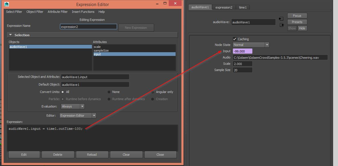

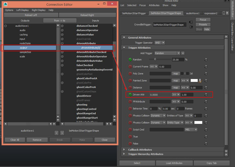

5. Create the audioWave node. BonusTools > Create > Utility Nodes > Create Audio Wave Node. If the option is greyed out, you would need to save the file or set the audioWave plug-in to Auto Load and restart Maya. Alternatively you can use the command “createNode audioWave”. To see the node in the outliner you would need to turn off “Show Dag Objects Only” for the outliner.
6. Connect the time1.outTime to the input of the audioWave. By default the audio file starts at the frame 1, if you want to offset the start then it is easier to set an expression for the input (for example: audioWave1.input = time1.outTime -100;)
7. Set the path for the audio file in the Audio field of the audioWave.
8. Connect the output of the audioWave to the drivenAttribute in the startTrigger for the behavior you want to trigger.
9. Set the conditions for the drivenAttribute Trigger.
10. Tweak the sample size and the scale to get the required value to trigger your MotionBehavior

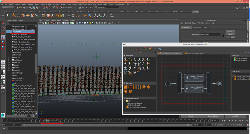

Example showing a wave motion triggered by an audio file
