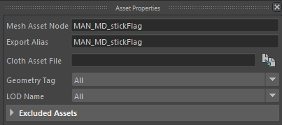

After importing the geometry to the character, you can still tag any mesh asset node to be part of a specific LOD Level in the mesh asset node / asset properties view.
A mesh tagged for a specific LOD level will display it in the Geometry Graph :

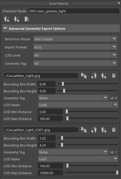

Then you can use the Character Maker's Geometry Tab "Export Geometry" button to export only
specific LOD Levels to each file, by picking the specific LOD Level in
the advanced Geometry Export options before export.
You will finally end up with different Geometry Assets listed in the Character Maker's Geometry Tab, and you will only have to tweak
the LOD (camera) distances in each of these files (the LOD Level should
have been prefilled when exporting the specific LOD Level to Geometry
File). Set those accordingly to your simulation: you'll be able to see
the corresponding geometry both at simulation and render time. Notice
that it is not required to reexport a Simulation Cache if you change
those attribute values.
See Asset properties LOD Min/Max Distance section for more details.

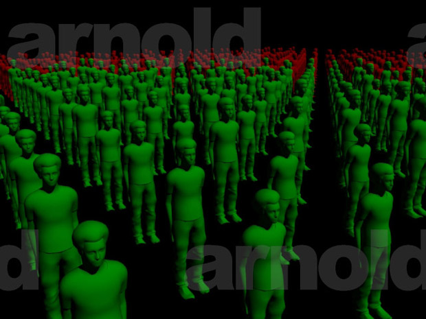

Here's how the render looks like with Arnold in Maya after exporting the simulation and adding a Crowd Render Proxy to the scene:
And to give you an idea of which geometry has been used where (red are low def characters and green are high def)

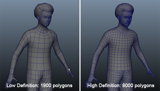

With LOD, the scene polygon count fell from 3 million to 1.6 million and render times reduced by more than 30% for this simple image.
