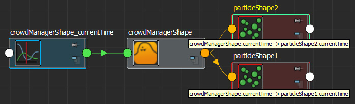

Using a Custom Keyframe Animation
If, for some reason, you're not able to use Maya Time Warp, you can also control the simulation time with a custom keyframe animation:
connectAttr -f crowdManagerShape.currentTime myParticleShapeName.currentTime;
