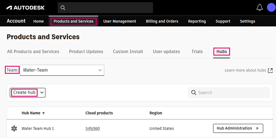

As a Team Admin, you need to activate Info360 Insight for your team by creating a hub. This is done from your Autodesk Account. A hub is associated with a team and contains one or more projects and their members. You can have one or more hubs (max. 10) per team (e.g., for different regions).
If you have more than one team in your Autodesk Account with an Info360 Insight product subscription, you will need to create a hub for each team.

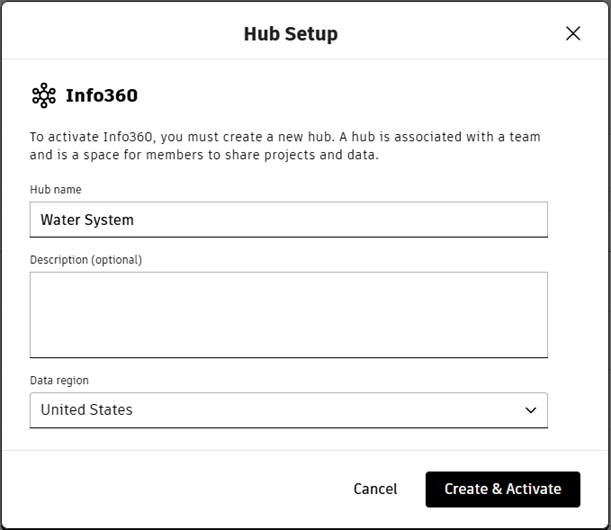

Before you can create a hub:
To create a hub:
Hubs.
Info360.
Once the hub is created, click on Hub Administration to start adding members and projects.
