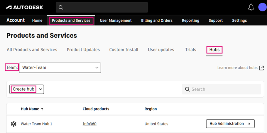

  1. Sign in to Autodesk Account (manage.autodesk.com).
  2. Go to Products and Services Hubs.
  3. Make sure the right Team is selected.
  4. Select Create hub Info360.

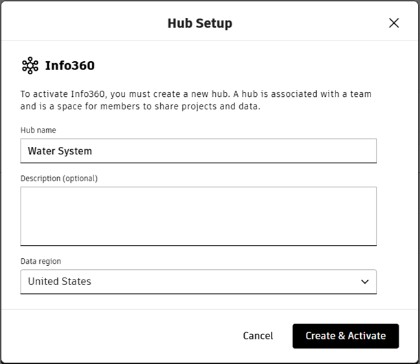

  5. Enter a Hub Name. For example, your team or company name.
  6. Under Data Region, select the region where your data should be hosted.
  7. Select Create & Activate.
