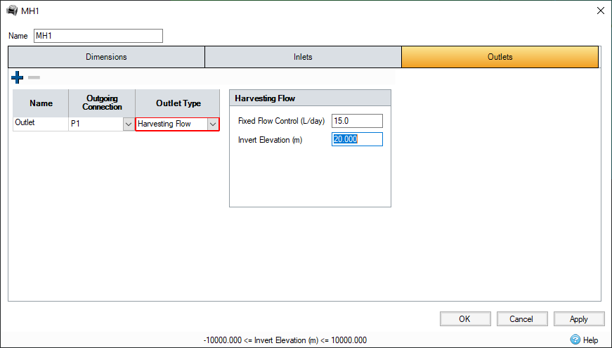

Harvest Flow
Harvesting Flow Outlet is a type of a Fixed Flow control - the constant flow rate occurs when the water elevation exceeds the invert elevation.
Specifications
Invert Elevation - Enter elevation when flow will commence.
Fixed Flow Rate - Enter the required constant flow rate.
