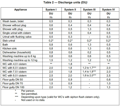

Default Discharge Units per Appliance values
The default Discharge Units per Appliance values come from the following table:
Where a range is given, the midpoint of this range is used in InfoDrainage.
Where a cell is marked as "** Not Permitted. " or "- Not used or no data. " that appliance is not available in that system, and the row for will be disabled.
