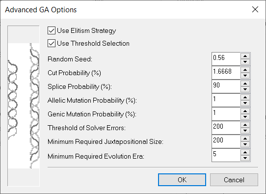

Advanced Genetic Algorithms Options
The Advanced GA Options page allows you to adjust the genetic algorithms (GA) settings for speed and efficiency. The default values provided will produce reasonable results over a wide range of modeling circumstances. The advanced options will allow you to fine tune the GA process if required.
Click on the dialog box below for additional information:
