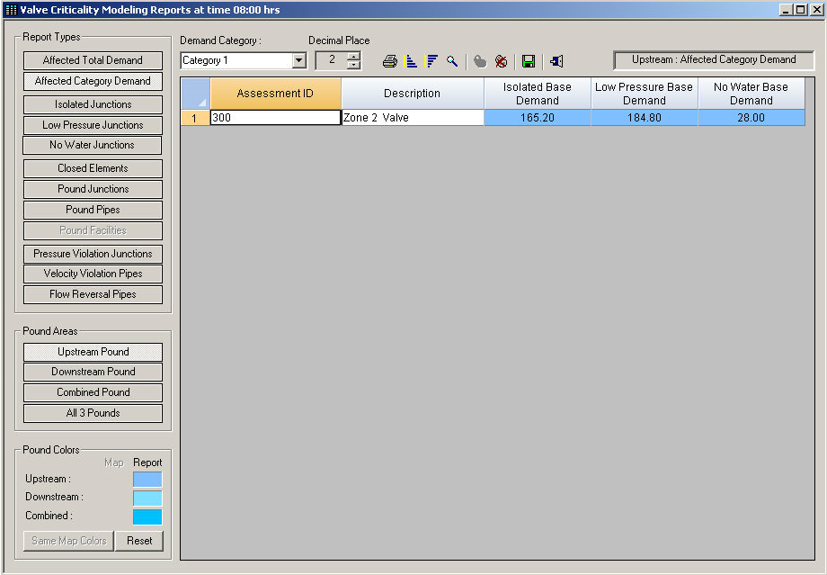

Affected category demand is the sum of base demands for each InfoWater Pro demand category (i.e., DEMAND1 through DEMAND10) expressed in the user’s defined units for each demand category.
Affected Category Demand is reported for each of the three hydraulic consequences: Isolated, Low Pressure, and No Water.
Some toolbar buttons may not be available for all reports. Toolbar items that are grayed are not available for this report type.
Assessment ID - The ID's of the elements assessed during the valve criticality analysis are listed in this column of the table.
Description - The description (From the InfoWater Pro Information Database Tables) of the element that was assessed.
Isolated base Demand - The category demand of all isolated junctions in the currently selected pound area.
Low Pressure Base Demand - The category demand of all low pressure junctions in the currently selected pound area.
No Water Base Demand - The category demand of all no water junctions in the currently selected pound area.
Use this option to select between Upstream Pound, Downstream Pound, Combined Pound or All 3 Pounds.
Displays the color scheme used for the pound report on the map display.
