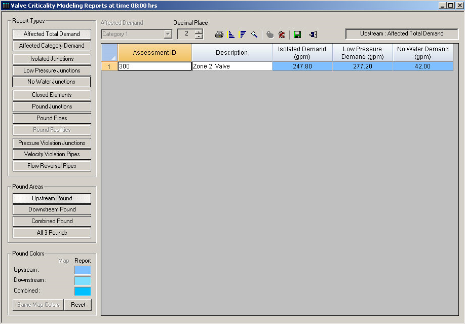

This view details the total instantaneous demand for each of the three hydraulic consequences: Isolated, Low Pressure and No Water. Choose from Upstream Pound, Downstream Pound, Combined Pound or All 3 Pounds.
The affected total demand is the sum of instantaneous demands in each of the three hydraulic consequences: Isolated, Low Pressure and No Water expressed as gpm (or liters/second)
Instantaneous Demand is determined by:
{(DEMAND1 x PATTERN1) + (DEMAND2 x PATTERN2) +…+ (DEMAND10 x PATTERN10)} x GLOBAL MULTIPLIER
for the selected simulation time.
Some toolbar buttons may not be available for all reports. Toolbar items that are grayed are not available for this report type.
Assessment ID - The ID's of the elements assessed during the valve criticality analysis are listed in this column of the table.
Description - The description (From the InfoWater Pro Information Database Tables) of the element that was assessed.
Isolated Demand - The total demand of all isolated junctions in the currently selected pound area.
Low Pressure Demand - The total demand of all low pressure junctions in the currently selected pound area.
No Water Demand - The total demand of all no water junctions in the currently selected pound area.
Use this option to select between Upstream Pound, Downstream Pound, Combined Pound or All 3 Pounds.
Displays the color scheme used for the pound report on the map display.
