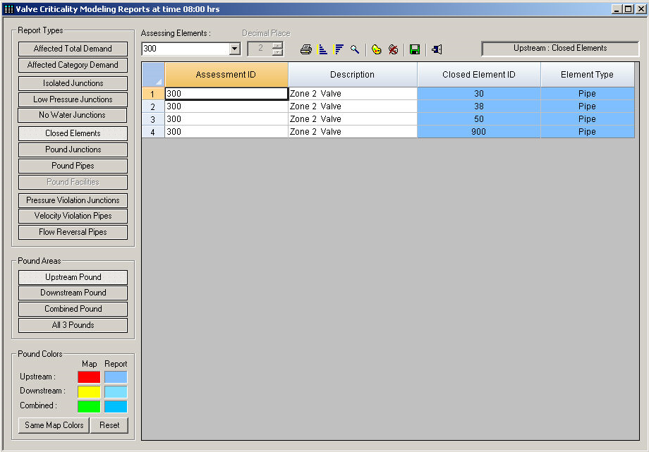

This dialog box details the closed elements from the CAM.
Some toolbar buttons may not be available for all reports. Toolbar items that are grayed are not available for this report type.
Assessment ID - The ID's of the elements assessed during the valve criticality analysis are listed in this column of the table.
Description - The description (From the InfoWater Pro Information Database Tables) of the element that was assessed.
Closed Element ID - ID's of closed elements in the currently selected pound area are listed in this column.
Element Type - The type of elements that are closed in the currently selected pound area are listed in this column.
Use this option to select between Upstream Pound, Downstream Pound, Combined Pound or All 3 Pounds.
Displays the color scheme used for the pound report on the map display.
