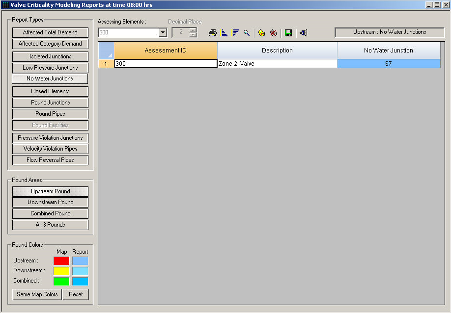

No water junctions are all hydraulically connected junctions that have a predicted pressure less than the No Water Threshold. In practice, the No Water Threshold is the pressure at which customers are assumed to be unable to receive water at the tap.
Some toolbar buttons may not be available for all reports. Toolbar items that are grayed are not available for this report type.
Assessment ID - The ID's of the elements assessed during the valve criticality analysis are listed in this column of the table.
Description - The description (From the InfoWater Pro Information Database Tables) of the element that was assessed.
No Water Junction - All no water junctions in the currently selected pound area are listed in this column.
Use this option to select between Upstream Pound, Downstream Pound, Combined Pound or All 3 Pounds.
Displays the color scheme used for the pound report on the map display.
