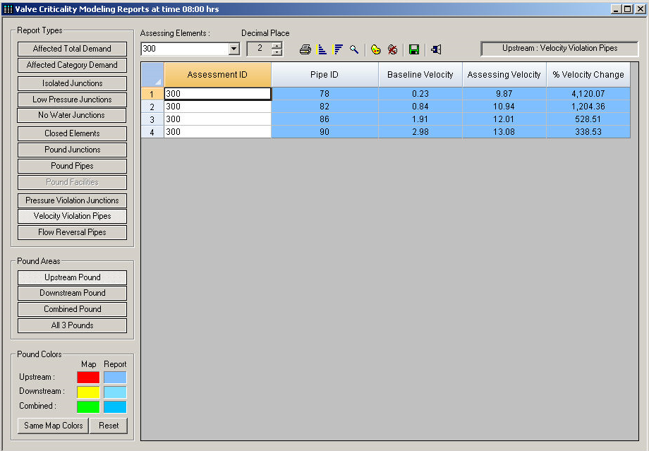

The Velocity Violation Pipes Report displays the pipes that have violated the Maximum Velocity Threshold.
Some toolbar buttons may not be available for all reports. Toolbar items that are grayed are not available for this report type.
Assessment ID - The ID's of the elements assessed during the valve criticality analysis are listed in this column of the table.
Pipe ID - ID of the pipe element.
Baseline Velocity - Velocity of the pipe prior to the assessment.
Assessing Velocity - Velocity of the pipe during the assessment.
Percent Velocity Change - The percent change in velocity from the baseline to the assessed velocity.
Use this option to select between Upstream Pound, Downstream Pound, Combined Pound or All 3 Pounds.
Displays the color scheme used for the pound report on the map display.
