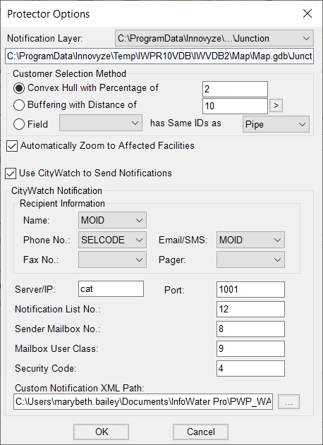

Option Screen
CityWatch administrator must set up CityWatch first before setting the options in the Protector. To specify the interface parameters, click Options.
Procedure
1. Select the Notification Layers which contains fields correspond to user information such as user names, phone numbers, and so forth.
2. Check Use CityWatch to Send Notifications to indicate that this option is turned on.
3. Specify recipient information by selecting the fields in the notification layer mapping to name, phone number, fax number, email/SMS, and pager.
4. Specify the CityWatch server name or IP address.
5. Specify the CityWatch port number. The default port is 1001.
6. Specify the CityWatch Notification List Number, Sender Mailbox Number, Mailbox User Class, and Security Code.
7. Finally, specify the location of the Custom Notification file. This file must be specified in CityWatch configuration for the specified mailbox.  During dispatch of notifications, this file will be populated with customer contact information for CityWatch to process.
