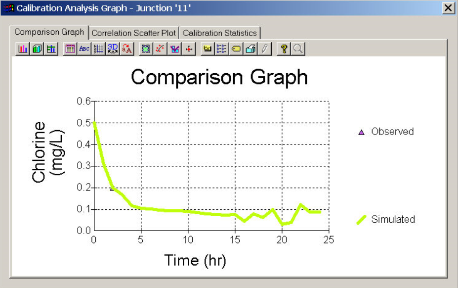

Comparison Graph
The Calibration Analysis Graph window is launched by clicking on the Graph button on the Junction Concentration tab and is composed of three tabs, the Comparison Graph as shown below and the Correlation Scatter Plot tab and the Calibration Statistics tab.
WQ Calibrator allows you to compare results of a simulation against measured field data as shown in the Comparison Graph Tab. This can be done via Time Series plots for selected components in the network. You have also many options to modify the appearance of the graph using the icons on the top of the window.
