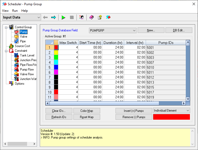

Use this tab to separate your pumps into groups. Pumps in the same group will receive the same schedule.

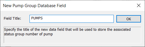

Pump Group Database Field - Select a Pump Group Field from the drop-down list. The pump group database field contains the group ID associated the pump. The drop-down list will display all user-defined data columns in the Pump Information database table. The pump group field must be numeric and contain a value that represents a pump group classification.
New - The New button creates a new data field column in the Pump Information database table containing the group ID for every pump in the network for which the status is to be optimized. When this button is selected you are prompted to enter the field title for this new database column.

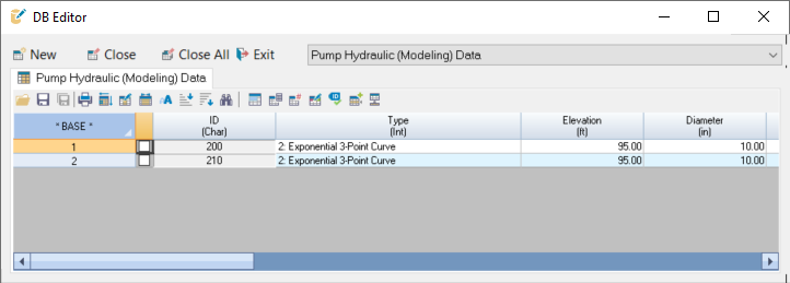

DB Edit - The DB Edit button opens the Pump Information database table from the DB Editor. The Pump Group information can be viewed and edited in the DB Editor.
The Active Group dialog box contains the following data columns:
Group Color - When the Color Map button is used (see below) the elements in each group will be colored with selected color. The color associated with each group is displayed here. Click on this item to change color of the associated group.
Max. Switch - Use this column to specify the maximum number of switches that the pumps in a pump group will turn on and off during an optimization run. Each change from an ON to OFF status or from an OFF to ON status counts as one pump switch.
Start Time - Use this column to identify the starting time for the optimal control algorithm. If a start time other than 00:00 is specified for a pump group, then the Initial Status for the elements in that pump group will remain unchanged until the specified hour is reached.
Duration - Use the Duration column to specify the length of time (duration of the control algorithm) over which the elements in a group will be optimized. The Start Time plus the Duration defines the total operating interval that the Scheduler will control the operation of the pumps for each particular pump group.
Interval - Use this column to specify the smallest time period that a element can be either ON/OPEN or OFF/CLOSED. This is listed in military time such as 01:00 for one hour and 00:30 for 30 minutes.
Pump ID - List the individual pump IDs to be included in the associated group.
Clear IDs - Delete all elements in the Active Group. To delete more than one group, highlight the desired group numbers, and then click Clear IDs.
Refresh IDs - Display the Element IDs in each of the groups to reflect any changes made using the Insert Element or Remove Element button.
Color Map - Color-code all elements in the Active Group with the Active Group associated color. To color code more than one group, highlight the desired group numbers and then press the Color Map button. Click on the Color box to change the color of the elements in the Active Group.
Reset Map - Reset the color of all pumps to their default color.
Insert (+) Pumps - Add elements to the Active Group based on the method chosen in the drop-down box to the right of this button.
Remove (-) Pumps - Remove elements from the Active Group based on the choice selected from the corresponding drop-down list.
Selection Method -
Individual Element: You can add one element by clicking on the individual element.
Elements in Selection: You can add one or more elements by clicking on the individual elements or by placing a graphical window around the desired group of elements.
Element IDs: You must key in the alphanumeric ID or label for each of the elements to be added to the Active Group.
Group Color - Displays the color associated with the currently selected group. Click on this area to change the color associated with this group.
Message Board - This section of the Scheduler dialog box will display a message upon successful completion of the commands that have been activated or pertinent error messages to the simulation.

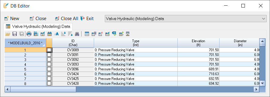

Use this section to separate the valves into groups. Valves in the same group will receive the same schedule.

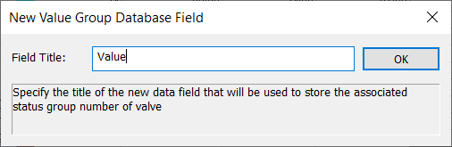

Valve Group Database Field - Select a Valve Group Field from the drop-down list. The valve group database field contains the group ID associated the valve. The drop-down list will display all user-defined data columns in the Valve Information database table. The valve group field must be numeric and contain a value that represents a valve group classification.
New - The New button creates a new data field column in the Valve Information database table containing the group ID for every Valve in the network for which the status is to be optimized. When this button is selected you are prompted to enter the field title for this new database column.

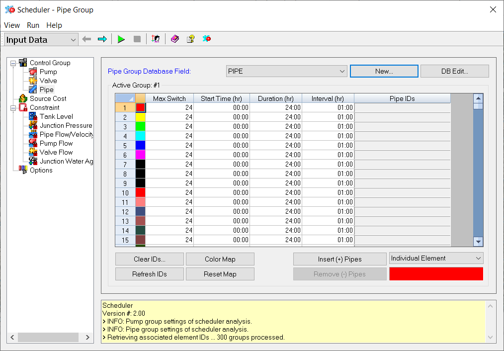

Use this tab to separate your pipes into groups. Pipes in the same group will receive the same schedule.
Pipe Group Database Field - Select a Pipe Group Field from the drop-down list. The pipe group database field contains the group ID associated the pipe. The drop-down list will display all user-defined data columns in the pipe Information database table. The pipe group field must be numeric and contain a value that represents a pipe group classification.
New - The New button creates a new data field column in the Pipe Information database table containing the group ID for every Pipe in the network for which the status is to be optimized. When this button is selected you are prompted to enter the field title for this new database column.

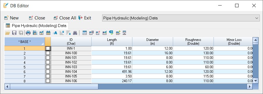

Pipe ID - List the individual pipe IDs to be included in the associated group.
Clear IDs - Delete all elements in the Active Group. To delete more than one group, highlight the desired group numbers and then click Clear IDs.
Color Map - Color-code all elements in the Active Group with the Active Group associated color. To color code more than one group, highlight the desired group numbers and then click on the Color Map button. Click on the Color box to change the color of the elements in the Active Group.
Insert (+) Pipes - Add elements to the Active Group based on the method chosen in the drop-down box to the right of this button.
Remove (-) Pipes - Remove elements from the Active Group based on the choice selected from the corresponding drop-down list.
Selection Method -
