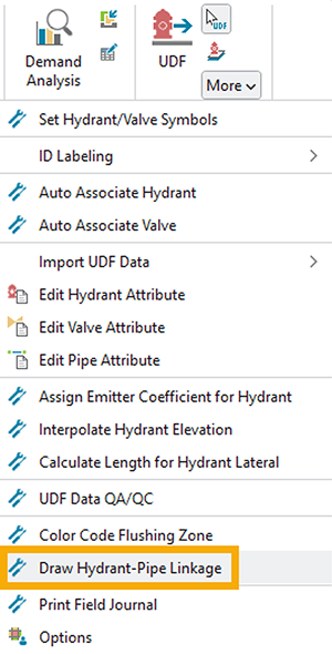

Draw Hydrant-Pipe Association Linkage
This tool draws a link (line) between the hydrant and the associated pipe. These links are used to create a shapefile of hydrant laterals. The laterals may be displayed or hidden at any time from the ArcMap Table of Contents. These lines is for visualization only and does not impact a UDF simulation.
These links (laterals) can also be imported using the InfoWater GIS Gateway.
