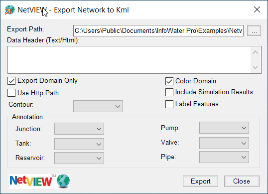

After InfoWater Pro is initialized, NetVIEW dialog box can be invoked through the InfoWater Pro > Apps > App Manager dialog box.
Once the menu item NetVIEW to Google Earth is selected the following dialog box will appear. Click on any portion to learn more.
Export Path - The Export Path feature allows you to specify the location of the final kml (Google Earth file extension) file.
Data Header (Text/Html) - This feature allows you to enter your organization’s header information to be included in the information display in Google Earth. For example, entering the following will display your company’s logo:
XYZ Inc <img src="http://www.xyzcompany.com/image/logo.jpg" > <br >
Export Domain Only - If a domain is previously specified, this option will only show the domain portion of the network in Google Earth.
Color Domain - This option will highlight the domain portion in red.
Use Http Path - When you want to export the map for web access, you should check the “Use Http Path” option so that the link in the kml content uses http prefix. Once the kml file is published to a website, you can access the kml from a browser.
Include Simulation Results - This option will export both the standard hydraulic/water quality simulation and the fireflow simulation results for each network element if they are available. For large network, this option may cause the export to take longer since all the EPS (e.g., 24 hours) simulation results are exported.
Contour - This option allows you to export a generated contour layer in InfoWater. (Available in NetVIEW Pro only.)
Label Features - This option will label all of the facilities with their IDs.
Annotation - This option allows you to specify a generated annotation layer for each type of system element in InfoWater Pro. (Available in NetVIEW Pro only.)
Export - It saves the InfoWater Pro project modeling results to Google Earth kml.
Close - It closes the NetVIEW dialog box.
