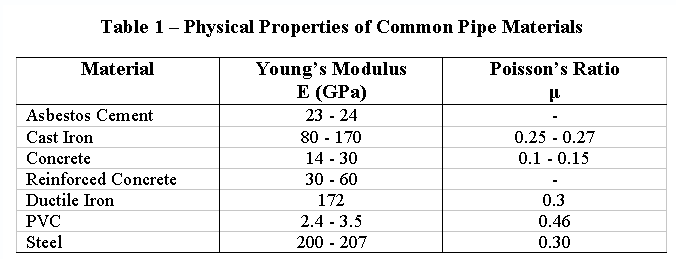

Table 1 gives physical properties of common pipe materials.
