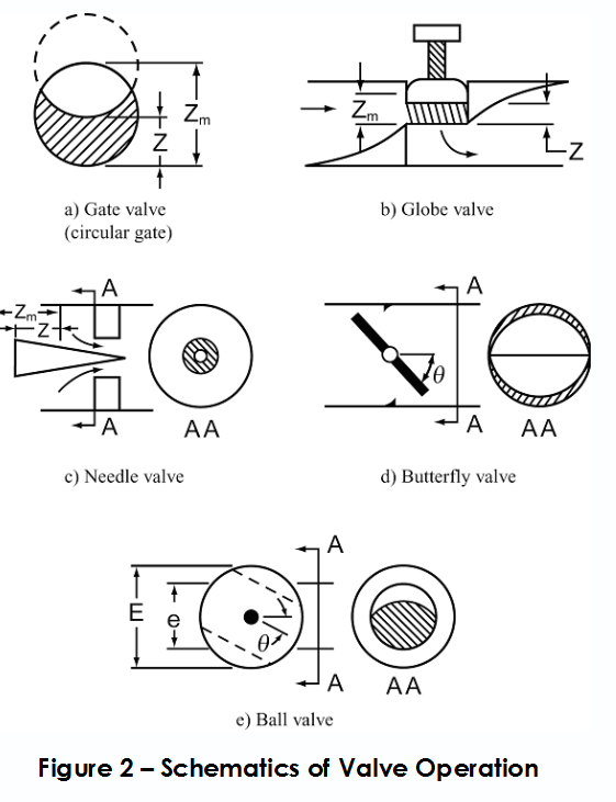

Schematics for valve operations for these valves are shown in Figure 2 below.
The geometric relations for each of these valves were analyzed to obtain the relation for the ratio of the open area, A0, to the area when the valve is fully open, AF, as a function of a translational movement of valve stem expressed as Z/Zm or a turning of the valve stem expressed as θ. These relations are given below.
Case a - Gate Valve (Circular Gate) - Figure 2(a) shows a Circular Gate Valve passing a circular opening. The area for this valve is given by:
where Zm is the maximum translational movement from the fully opened to the fully closed position.
Case b - Globe Valve - Figure 2(b) represents a Globe Valve. The flow area is a ring, the height of which is determined by the position of the valve stem. The open area ratio varies linearly and is given simply as:
Case c - Needle Valve - Figure 2(c) depicts a Needle Valve. The flow is the area between two concentric circles.  The area ratio is given by:
Case d - Butterfly Valve - A Butterfly Valve is shown in Figure 2(d). The area ratio is given by:
in which 0 ≤ θ ≤ π/2.

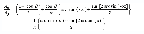

Case e - Ball Valve - Figure 2(e) depicts a Ball Valve that is described by
in which
in which e = the diameter of the open cylindrical passage and E = the diameter of the ball. The angle, θ, through which the valve stem must be turned to completely close the valve is given by the solution of the following:

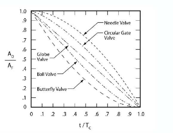

Figure 3 below depicts a complete closure operation for these five valves due to a linear movement of the valve stem from the fully opened to fully closed positions. It is possible that the valve stem may be accelerated from the first position to the second position. This type of closure might be expected for fast acting valves such as spring-loaded check valves or solenoid valves. Valves that can be closed with a quarter turn of a lever or a single thrust of a plunger would be expected to close in some sort of accelerated fashion.
Figure 3 – Closure Functions for Standard Valves (Linear Valve Stem Movements)
