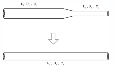

Series Pipes
Pipes connected in series might have different C-values and/or lengths and well as different sizes as shown in the figure below.
It is possible to replace series pipes by an equivalent pipe. Noting that the same flow must pass through each pipe in a series, the equivalent pipe is determined as the pipe which will carry this flow rate and produces the same head loss as the series pipes (sum of all individual head losses).

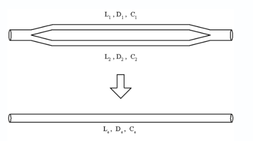

Parallel Pipes
An equivalent pipe can be used to replace two or more pipes in parallel. Noting that the head loss in each parallel pipe must be equal, the basic principle behind the concept of an equivalent pipe is to replace parallel pipes by a single pipe which will transport the same total flow rate for the same head difference between the connecting nodes.
