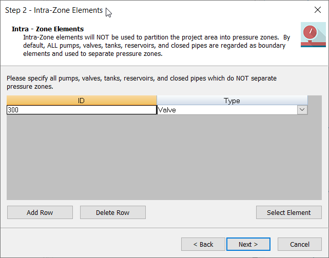

Intra-zone Elements
In this screen, you can note any intra-zone elements that will not be used to partition the project area into pressure zones. If you would like to ignore certain elements as a zone boundary, select Add Row and use the drop-down list to enter the element Type. You can then populate the element ID by typing in the ID, or select the element ID cell and use the Select Element button to select the desired element in the map view.
Select Next to go to the next screen or select Back to return to the previous screen.
