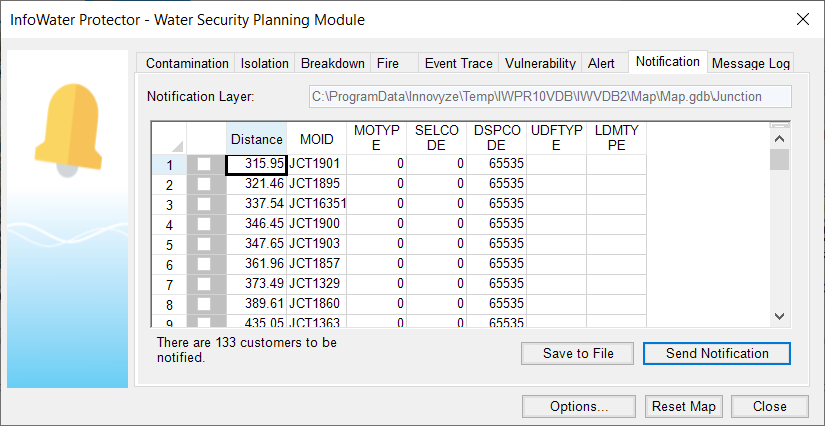

The Notification tab of the Protector enables you to utilize GIS-based parcel information for the purpose of notifying customers who may be affected by a contamination, node isolation, pipe breakdown, or an event trace condition. Generating a of list of customers for notification purposes is dependent upon having an established GIS customer parcel base coverage.
The GIS-based layer that contains customer information as specified via the Options
button.
Send Notification - Click on the Send Notification
button to send notifications to affected customers.
Save to File - Click on the Save to File
button to save the list of affected customers to a text file.
Options - The Options
button is used for assigning the GIS-based layer to be used for conducting a customer notification.
Reset Map - Click on this Reset Map
button to reset the map display to its default state.
Close - Click Close
to close the Protector dialog box. To conduct another water security analysis, simply click on another analysis tab in the Protector dialog box.
