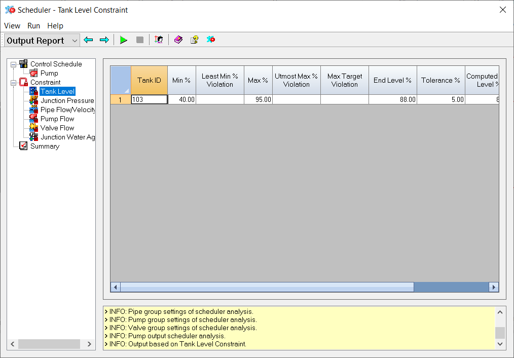

Under the Constraint viewer in the Output Report window, you will find a list of numerical results and infractions from the last successful simulation. Details of each constraint are shown below.
Tank ID - Specifies the unique identifier for your Tank Output Results.
Min % - The minimum tank level constraint (percent format) entered in the input data.
Least Min % Violation - The smallest amount the minimum or maximum level was violated for the corresponding tank or reservoir (ID in the same row) during the scheduler optimization.
Max % - The maximum tank level constraint (percent format) entered in the input data.
Utmost Max % Violation - The largest amount the minimum or maximum level was violated for the corresponding tank or reservoir (ID in the same row) during the scheduler optimization.
Max Target Violation - The largest amount the computed tank level differed from the target level during the last successful Scheduler run.
End Level % - The final tank level constraint (percent format) entered in the input data.
Tolerance % - The tank level tolerance constraint (percent format) entered in the input data.
Computed End Level % - The computed final tank level (percent format) after a scheduler run.
Target Level ID - The Pattern ID representing the tank level constraint entered in the input data.
This section of the Scheduler dialog box will display a message upon successful completion of the commands that have been activated or pertinent error messages to the simulation.

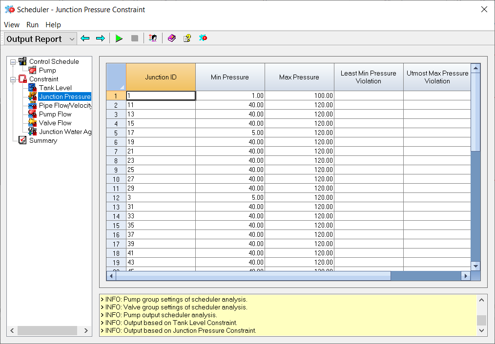

Junction ID - Specifies the unique identifier for your junction ID's.
Min Pressure - The minimum junction pressure constraint entered in the input data.
Max Pressure - The maximum junction pressure constraint entered in the input data.
Least Min Pressure Violation - The smallest amount the minimum or maximum pressure was violated for the corresponding junction (ID in the same row) during the scheduler optimization.
Utmost Max Pressure Violation - The largest amount the minimum or maximum pressure was violated for the corresponding junction (ID in the same row) during the scheduler optimization.

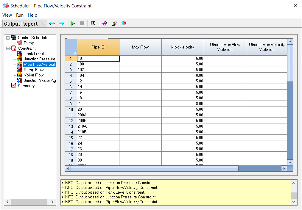

Pipe ID - Specifies the unique identifier for your pipe ID's.
Max Flow - The maximum pipe flow constraint entered in the input data.
Max Velocity - The maximum pipe velocity constraint entered in the input data.
Utmost Max Flow Violation - The largest amount the maximum flow rate was violated for the corresponding pipe (ID in the same row) during the scheduler optimization.
Utmost Max Velocity Violation - The largest amount the maximum velocity was violated for the corresponding pipe (ID in the same row) during the scheduler optimization.

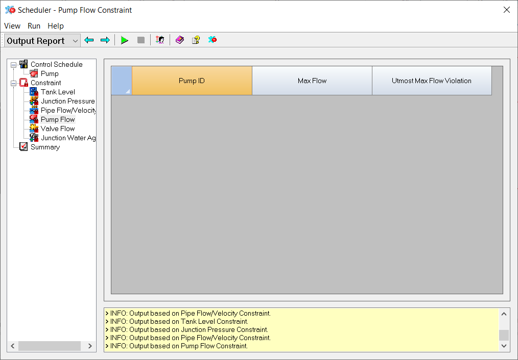

Pump ID - Specifies the unique identifier for your pump ID's.
Max Flow - The maximum pump flow constraint entered in the input data.
Utmost Max Flow Violation - The largest amount the maximum flow rate was violated for the corresponding pump (ID in the same row) during the scheduler optimization.

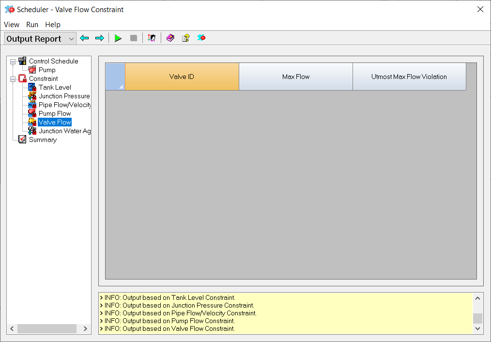

Valve ID - Specifies the unique identifier for your valve ID's.
Max Flow - The maximum valve flow constraint entered in the input data.
Utmost Max Flow Violation - The largest amount the maximum flow rate was violated for the corresponding valve (ID in the same row) during the scheduler optimization.
