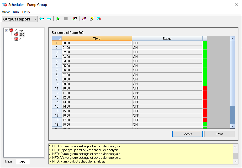

The Detail tab of the Output Report Tab shown schedules for all elements included in the scheduler analysis. Click on a feature ID on the left to see the optimized schedule for the selected element on the right side of the dialog box.
Time - Details time periods for operations.
Status - Details the optimal on / off status of the feature at the each time period as determined by the Scheduler.
Status Bar (Color Code) - Red means the feature is off at the time period. Green means the feature is on at the time period.
Locate - This button zooms to the selected element on the map view.
Print - Use the Print button to send the current Control Schedule to the printer.
This section of the Scheduler dialog box will display a message upon successful completion of the commands that have been activated or pertinent error messages to the simulation.
