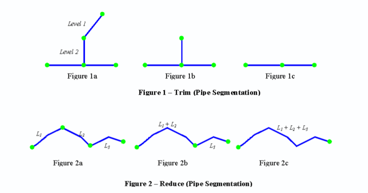

RST is an iterative process, and the order in which each application is executed will result in distinct network segmentations. Although the skeletonize application is a direct one-step segmentation process, both the reduce and trim applications are iterative in nature because many consecutive segmentation levels may exist that meet the desired segmentation criteria. Figures 1a-c depicts a two-level network trimming application while Figures 2a-c illustrate a two-level network reduction application. In addition, mains removed during the execution of the skeletonize and trim applications may require the reduce routine to be re-executed to further remove excess nodes.

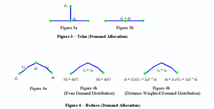

While network skeletonization can be carried out directly using the Facility Manager of H2ONET ANALYZER , the H2ONET SKELETONIZER Skeletonizer effectively complements H2ONET Suite by providing added capabilities for network data reduction, merging, and trimming. For these two added applications, the H2ONET SKELETONIZER will automatically re-calculate and re-allocate demands at all affected junction node to preserve the total demand in the system. When trimming a pipe segment with a downstream dead end node, the demand at that node is automatically shifted to the pipe’s upstream node as shown in Figures 3a-b. Two methods are provided for automatically re-allocating nodal demands during a network reduction application. These include a distance-weighted approach (Figure 4a) and an evenly-distributed approach (Figure 4b).
