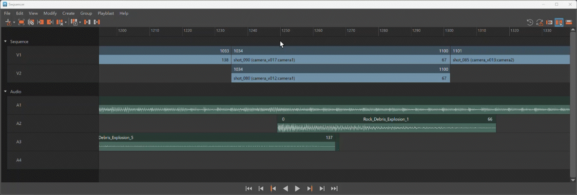

Group shots in the Sequencer editor
You can group shots in the Sequencer editor to organize related shots and manage them as a single unit. Groups are displayed as a single node in the Sequencer editor and contain one active shot that is used during playback. Shot groups can be color coded to visually distinguish them in the timeline. When a shot group is selected, the shots in the group move together when repositioned in the sequence.
Create a group of shots
To group shots:
  1. Select one or more shots.
  2. In the Sequencer editor menu bar, select Group > Create Group.
A new group is created containing the selected shots. The first shot alphabetically becomes the active shot for the group.
The group is drawn at the position of the active shot and displayed in purple. Any additional shots in the group are hidden from the Sequencer editor view.
