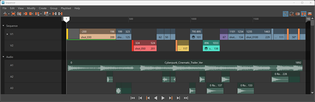

You can also use Sequencer, which lets you lay out and manage camera shots, then produce rendered movie footage of the animation in your scene. In Sequencer, shots are represented as a set of rectangles arranged on tracks, and you define and manipulate which camera is active at any point in time by manipulating the camera shots. When you’re satisfied with the layout and timing of camera shots, you can playblast movie clips of the animation.

What is Sequencer?
Sequencer is a tool that lets you create, re-arrange, and manipulate camera shots of your scene. Each shot defines which camera is active at any particular time, and for how long.
By adjusting the placement and timing of camera shots, you can effectively manage the ‘filming’ of the animation in the scene. When you finish manipulating camera shots in the Sequencer, you can playblast the sequence into a rendered movie clip.
See also Sequencer.
