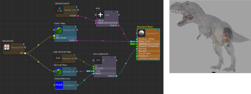

The following example demonstrates how to use the vertex color blue channel to control opacity.
Select the Opacity channel on the Standard Base node to show its Attribute Editor and set the Component Swizzle value to b.
Select Transparent from the Blend Mode drop down list.
The 0.5 value added to the blue vertex color channel causes all areas with blue to be semi-transparent.
A significant amount of blue was painted on dinosaur's leg. These areas are now more opaque than other areas since it is the blue channel that determines the opacity.
