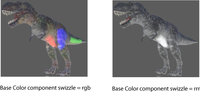

In ShaderFX, RGB values are connected to XYZ by default. By default, X corresponds to R, Y to G, and Z to B. However, you can provide a float3 input of xxx or rrr - that is, the red channel is used for all of the 3 float values of float3. You can also provide rgg or xyy, where the red channel is used for the first float and the green is used for the second and third.

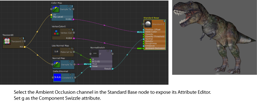

Its Attribute Editor appears.
If the Component Swizzle field is empty, the default values are used (for example, rgb for xyz).
The following example demonstrates the different effects when the Base Color input is xyz (rgb) versus when the Base Color input is rrr.

In this example, you can see the ambient occlusion on parts of the dinosaur's tail where it was painted green.
The r and b channels of vertex color can now be connected to other inputs; for example, r for Metallic and b for Roughness.
