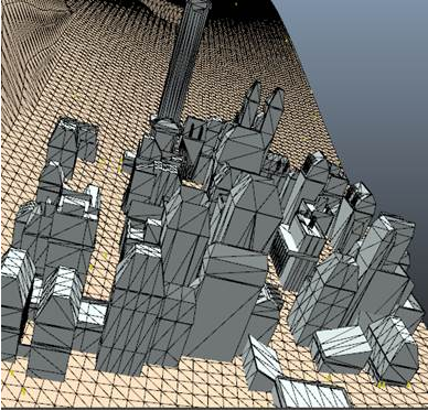

Option: Using heightfields for better performance
Instead of providing the NavData generation system with the individual triangles that make up each sector of your terrain, you can provide it with heightfields and triangulated meshes.
A heightfield is an optimized way of expressing the altitude of a simple single-story terrain. Instead of containing all of the triangles that make up the terrain mesh, it consists of a single origin point, plus a set of altitude values sampled in a regular grid around the origin. Because the data is much more compact and less complex than a full triangulated mesh, it offers lower runtime memory usage and much greater performance in collision tests.
The negative side of using heightfields is that they are typically also less accurate to local variations in height that occur within the spacing of the samples in the grid. This can cause the NavMesh produced from the heightfields, and the collision tests that are conducted against them, to be less accurate. To offset this lack of accuracy, you can also provide triangulated meshes for the more complex areas of the terrain, where closer fidelity to the smaller features of the terrain is needed.
To get the best compromise between efficiency and accuracy, use heightfields to represent wide-open areas such as fields, and triangulated meshes to represent areas where you need greater precision, such as city blocks. For example:
To provide heightfields and indexed meshes for a sector, you must update your implementation of GeneratorInputProducer::Produce() in the GeneratorInputProducer that you use in your NavData generation pipeline to pass the terrain geometry to the NavData generation system.
To provide heightfields for a sector:
To provide triangulated meshes for a sector:
Note that when you use this approach, NavData is generated on your heightfields and triangulated meshes. It is therefore unnecessary to provide individual triangles directly to the ClientInputConsumer.
