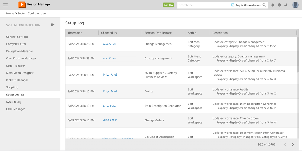

Use the Setup Log to track workspace setup activity on your Fusion Manage site. Each log entry records when an action occured, who performed it, the type of action and in which workspace, along with additional details.
To access the Setup Log:
  1. Open the main navigation menu.
  2. Go to Administration > System Configurations > Setup Log.
Setup log
