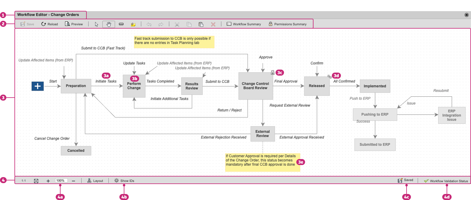

Workflow editor
The Workflow Editor lets administrators create and manage workflow maps in a workspace. To open the Workflow Editor:
  1. From the main menu, go to Administration > Workspace Manager.
  2. In the Workspace Manager, expand a workspace's panel.
  3. Click Workflow Editor. Workflow editor UI
  4. Title bar: Displays the name of the workspace whose workflow map is currently open.
  5. Toolbar: Provides tools for creating, editing, and managing the workflow map.
  6. Workflow mapping grid: The central area where the workflow map is displayed and edited. It includes:
    3a. Transition: Defined actions that move items between states
    3b. State: Represents steps in the workflow
    3c. Locked state: Indicates a state where items become locked
    3d. Managed state: Indicates a state where revision-controlled items are revisioned
    3e. Notes: Provides instructions or documentation within the workflow map
  7. Status bar: Displays workflow editor status and other controls, including:
    4a. View controls: Adjusts the display of the workflow map
    4b. Show IDs: Shows or hides states and transition IDs in the Properties dialog. Reverts to off when the editor is closed.
    4c. Save status: Indicates whether there are unsaved changes
    4d. Workflow validation status: Indicates validation errors. Click to view error details and jump to the error location in the map.

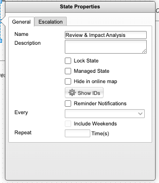

State properties
Double-click a workflow state to open the State Properties dialog.
state properties dialog
From this dialog, you can configure the state and designate it as:
State IDs and scripting
State IDs are important if you want to use server-side scripting to control workflows. Each workflow state has two IDs:
To display the state's ID in the State Properties dialog, click Show IDs. This resets when the dialog is closed.

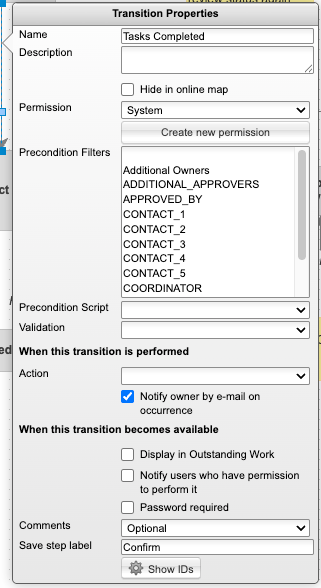

Transition properties
Double-click a workflow transition to open the Transition Properties dialog.
transition properties dialog
Transition properties include:
Transition IDs and scripting
Transition IDs are important if you want to use server-side scripting to control workflows. Each workflow transition has two IDs:
To display the transition's ID in the Transition Properties dialog, click Show IDs. This resets when the dialog is closed.
Legacy scripts
The Precondition Script and Validation drop-down lists in the Transition Properties dialog do not display the names of legacy scripts. If a transition uses a legacy script, the corresponding drop-down list appears empty and a scroll icon is shown next to it. To view the name of the legacy script, hover over the scroll icon.
