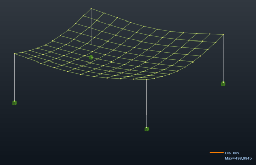

The Deformation result shows the distortion and the changes in the shape or dimensions of the structure. These changes or distortions result from the loads applied on the structure.
Deformation
Example of a deformation of a simple structure
