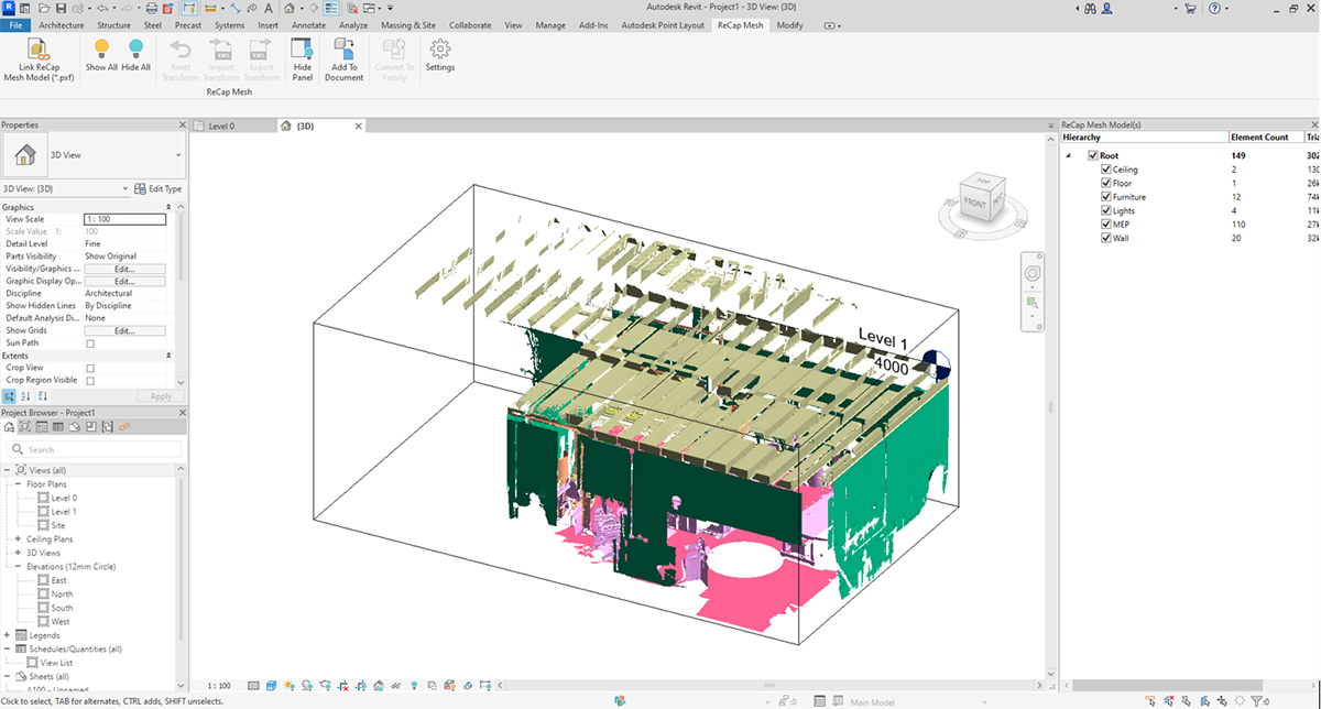

This section introduces the workflow for using ReCap mesh models in Revit through the RCMR format. This integration follows mesh classification and export in ReCap Pro and supports coordinated design workflows in Revit.
Through the ReCap Scan to Mesh workflow it is possible to export a unique file format (*.rcmr) that stores the segmented mesh model for use in Autodesk Revit, using features available as part of the ReCap Pro integration with Revit.
