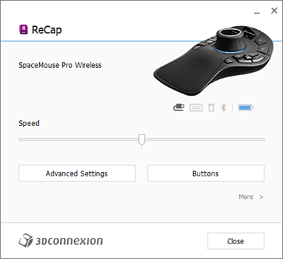

To set up a SpaceMouse for ReCap
Install the necessary 3Dconnexion drivers for your SpaceMouse on your machine from https://3dconnexion.com/us/drivers/.
Once installed, the 3Dconnexion Home Menu displays.
Connect the 3Dconnexion SpaceMouse to your computer.
Verify that the SpaceMouse is working correctly by using the demo application that installed with the drivers.
Launch ReCap Pro.
Open the 3Dconnexion settings to customize the SpaceMouse for your ReCap workflows.
For details on using SpaceMouse, go to the 3Dconnexion website and download the specific product manual.
