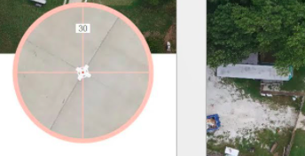

Improvements have been made to the image stitching rate ReCap Photo, allowing for features to be detected from more images within the image set.
Another improvement is regarding image sets that are disconnected in terms of overlaps. ReCap Photo will now output the results of the largest area in the image set that has the best overlaps. For example, if a dataset of 400 images is processed and this dataset has an overlap disconnect between the first 100 and the remaining 300 images, ReCap Photo will process and provide outputs for 300 images. Control Points and Checkpoints will behave as usual. If a control point was present in the first 100 images, that control point will be considered invalid.
