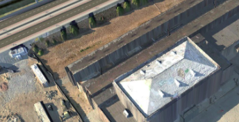

Improvements have been made to the image stitching rate ReCap Photo, allowing for features to be detected from more images within the image set.
