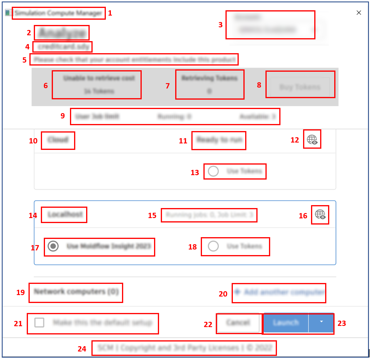

Compute Manager Analyze Interface
Figure 1 shows the layout of the Compute Manager Analyze interface.
Figure 1: Simulation Compute Manager Analyze interface, showing
- Simulation Compute Manager dialog title
- Analysis title (Product depenedent. See the Product's documentation for details.)
- Cloud account selection menu, if you have access to multiple accounts
- Title of job being launched (Product dependent. See the Product's documentation for details.)
- Error messages
- Cost in Tokens
- Token balance for selected account
- Buy Tokens link
- Product meta data (See the Product's documentation for details.)
- Cloud
- Job Viewer link to view status of Cloud jobs
- Use Tokens for Cloud job
- Computer name. Localhost or Network Computer
- SCM Provisioner limit and running jobs for computer (14)
- Job Viewer link to view status of jobs on computer (14)
- Use the product license to submit the job to the Queue on computer (14)
- Use Tokens to submit the job to the Queue on compute (14) (Product dependent. See the Product's documentation for details.)
- List of Network Computers
- Add or remove Network Computers
- Option to make the current setup default, the next time the dialog is opened. Cloud cannot be selected as the default.
- Cancel the session. Changes are not be saved, and jobs are not launched.
- Launch the job to the selected Queue or to the Cloud.
- Copyright and 3rd party license information
