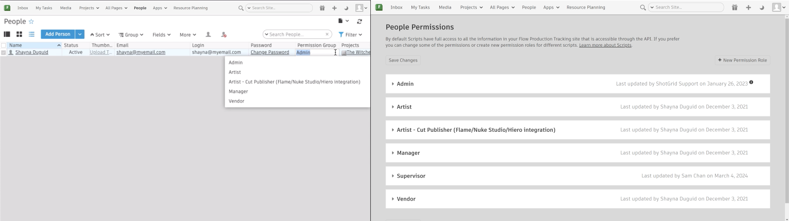

Let’s walk through the best practices for assigning permissions in Flow Production Tracking before we start to add our crew. Starting from our People page, let’s do a side-by-side comparison with our People Permissions page. Flow Production Tracking ships with a handful of default permission roles which determine what users can see and do. Artists and Vendors have the most restrictions.
