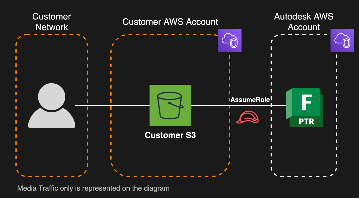

media-isolation-arch-fptr

When using Flow Production Tracking to upload and download media it is transferred directly to / from AWS S3 without transiting through Autodesk infrastructure. Flow Production Tracking will only access media in two situations:
  1. The Flow Production Tracking Transcoding service will get read/write access once, soon after upload, when transcoding the media. See ephemeral transcoding for details.
  2. When the Flow Production Tracking service generates S3 Links to your sources and transcoded media.
This is rendered possible by leveraging AWS AssumeRole keyless Security Token Service. When setting up Media Isolation, an AWS Role allowing Flow Production Tracking to access your media for the action listed above is created, and the Flow Production Tracking service is allowed to assume that role.
Flow Production Tracking Support staff do not have access to your S3 Bucket under any circumstances.
