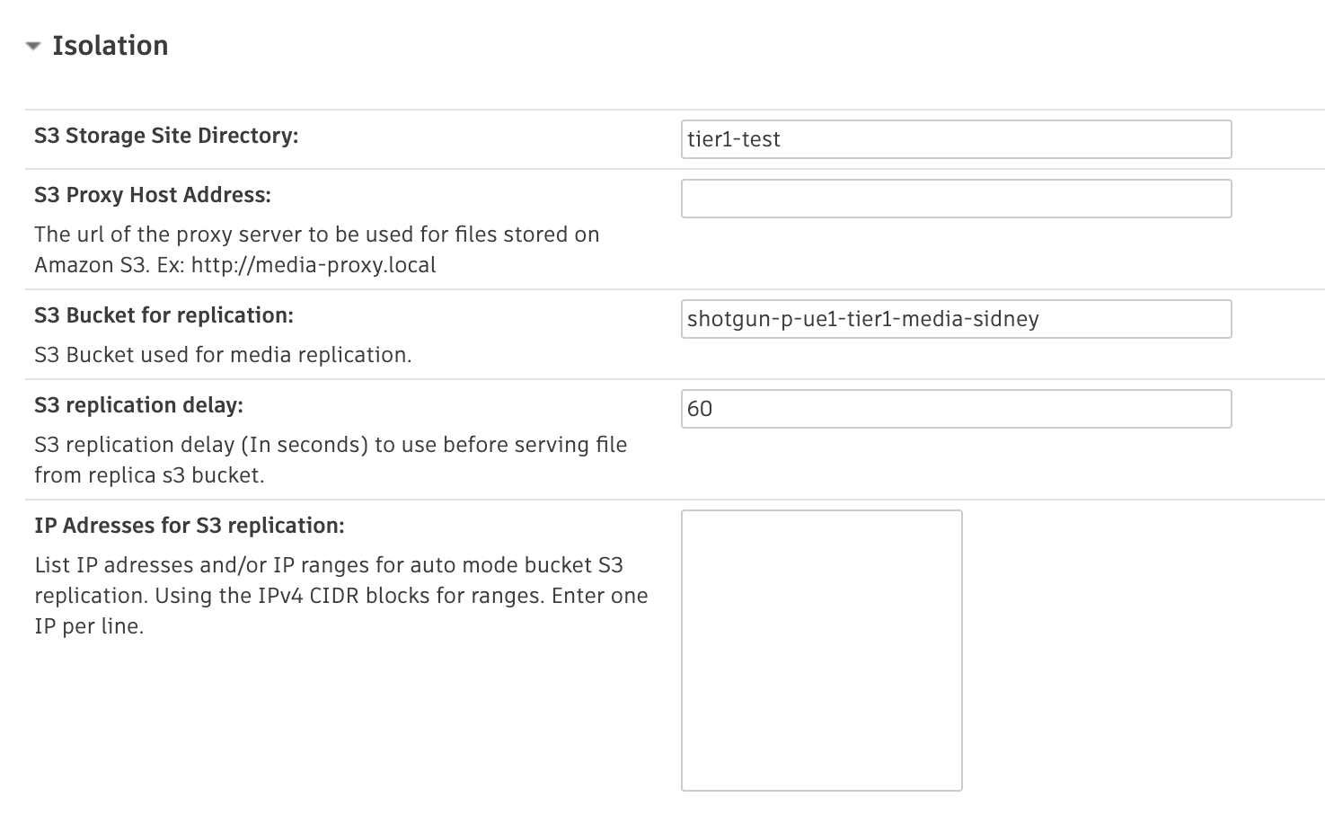

When using Media Replication, each user can customize which region data is read from. A user can either specify the region to use, or use automatic mode. In automatic mode Flow Production Tracking selects the replica determined by the user's IP address using IP ranges specified in the Isolation Preferences.

A small amount of time, typically under 15 minutes, is required before replication happens. The replication time depends on the size of the object to replicate. In order to alleviate that replication delay, Flow Production Tracking will, for a small period of time, generate links from to object in the source bucket instead of the replica. The duration of this transitional state is configurable in the Isolation Preferences.
