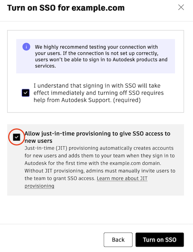

Before turning on SSO
To enable JIT provisioning before turning on SSO, click the checkbox "Allow JIT provisioning to give SSO access to new users."

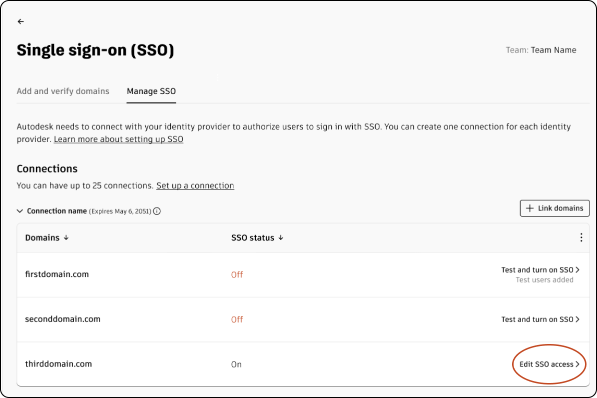

After turning on SSO
To enable JIT provisioning after turning on SSO, click Edit SSO access under your SSO connection in Autodesk Account.

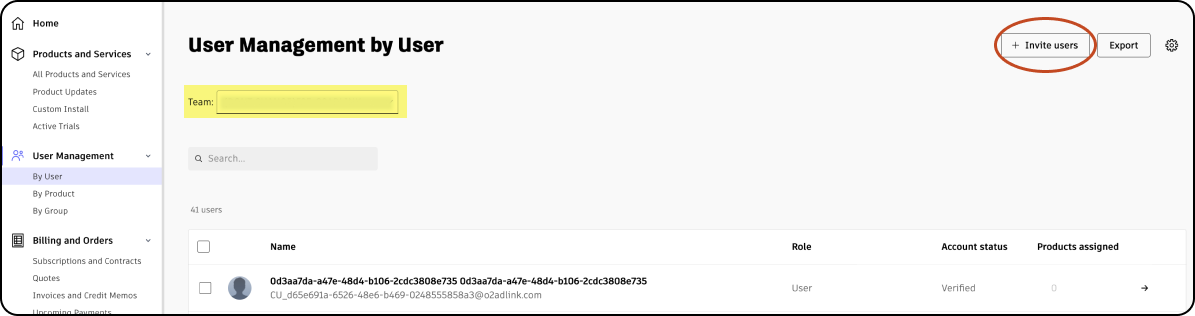

To invite users to your team so they can sign in with SSO:
  1. In Autodesk Account, go to User management > By user.
  2. Select the team to which you want to invite the user.
  3. Click the + Invite users button.
  4. Fill in the user's details in the Invite Single tab and click Send invite to send the invite.
