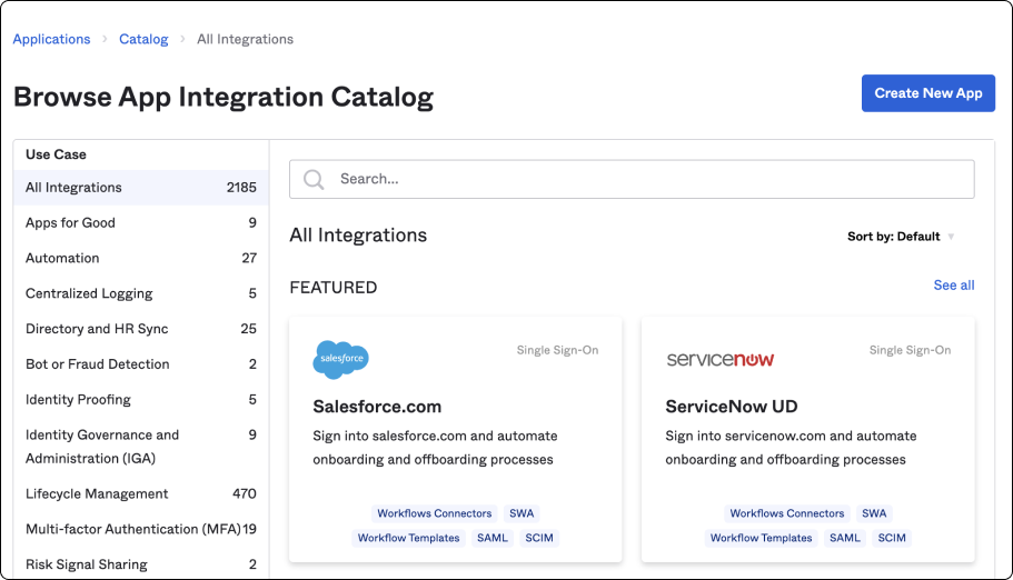

Click the Browse App Catalog button.

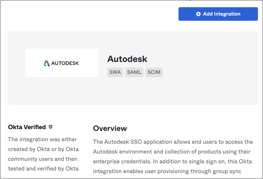

Search for the "Autodesk" application and click the Add Integration button.
This application is pre-configured with all the essential settings including the SAML attributes mapping. Refer to the manual configuration procedure in case of any issues with the Autodesk pre-configured template or to view/update the SAML mapping source.
Name the Application label and click Done.

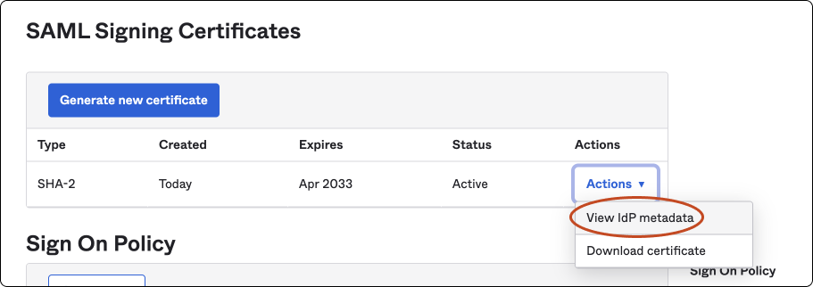

Select the Sign On tab and scroll down to section SAML Signing Certificates.
Click Actions. Right click View IdP Metadata to select Save Link As and save as .XML file.

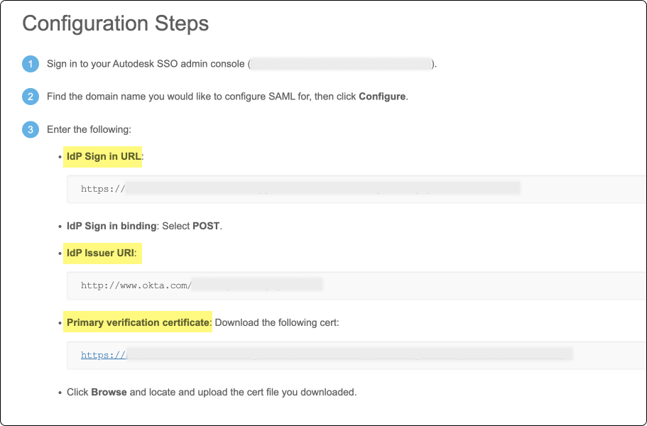

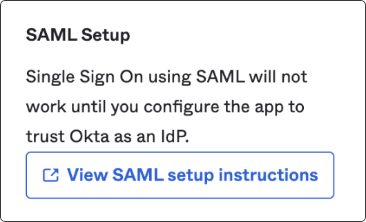

Select the Sign On tab to scroll down and click View SAML setup instructions.
Copy the Idp Sign in URL, Idp Issuer URI values and in section Primary verification certificate, click the URL link to download.
Go back to Autodesk Account to paste the Okta values and upload the certificate as shown in the table.
| Okta | Autodesk |
| IdP Issuer URI | Entity ID |
| Idp Sign in URL | Sign-on URL* |
| Primary Verification Certificate | Verification Certificate |
Confirm that the fields are filled in and click Next in Autodesk Account.

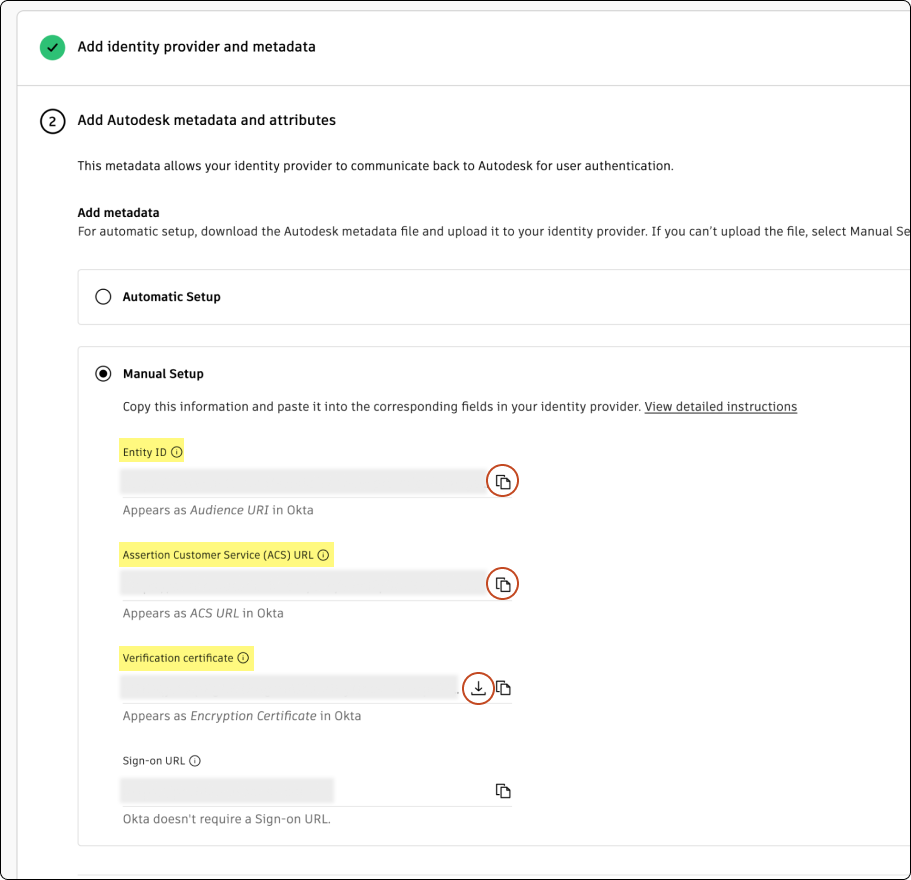

In Autodesk Account, copy the Entity ID, Assertion Customer Service (ACS) URL, and download the Verification Certificate.

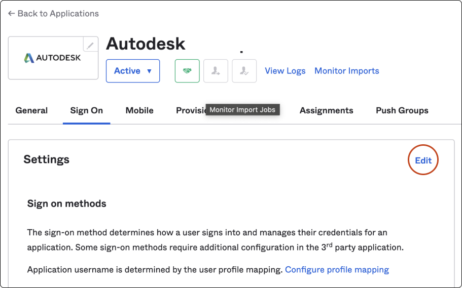

Return to Okta portal. Make sure you are in Sign On > Edit.

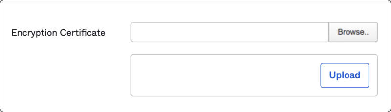

In section SAML 2.0 > click Browse to select the .crt file you downloaded from Autodesk Account and click Upload.

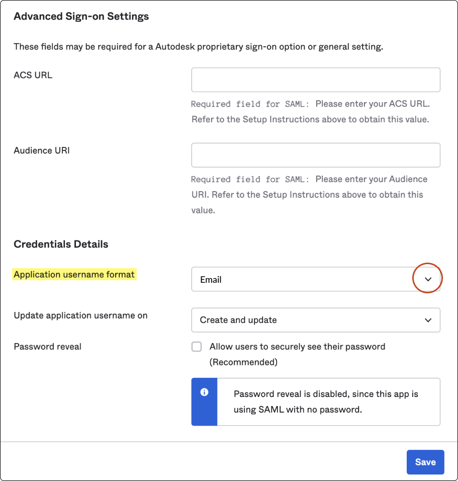

In section Advanced Sign-on Settings, enter the values noted from Autodesk Account in step 1 as shown in the table.
| Autodesk | Okta |
| Entity ID | Audience URI |
| Assertion Customer Service (ACS) URL | ACS URL |
Under the Credentials Details > Application username format, select Email from the dropdown and click Save.

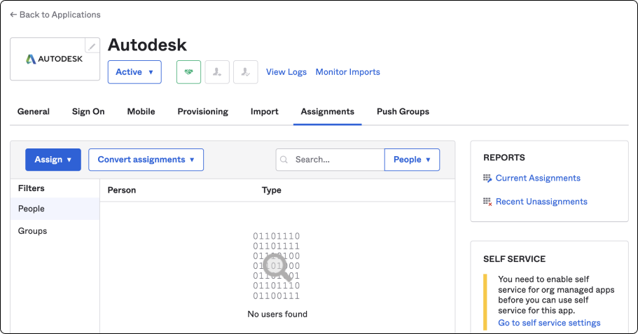

Before testing the connection, make sure you assign yourself access to the Autodesk SSO application that you created with your identity provider. Go to Assign an app integration to a user for more information.

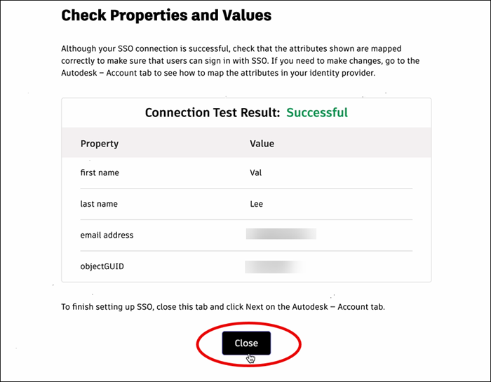

Sign in to make sure that the connection between your identity provider and Autodesk is set up correctly. If the test is successful, you will see the message “Connection Test Result: Success” and a list of properties.
Confirm that the attributes have mapped correctly by comparing the Property and Value columns. The property “first name” should appear next to the user’s first name, “last name” should appear next to the user’s last name, and so on. If you need to make changes, return to the previous step (Mapping attributes) and re-map the attributes.

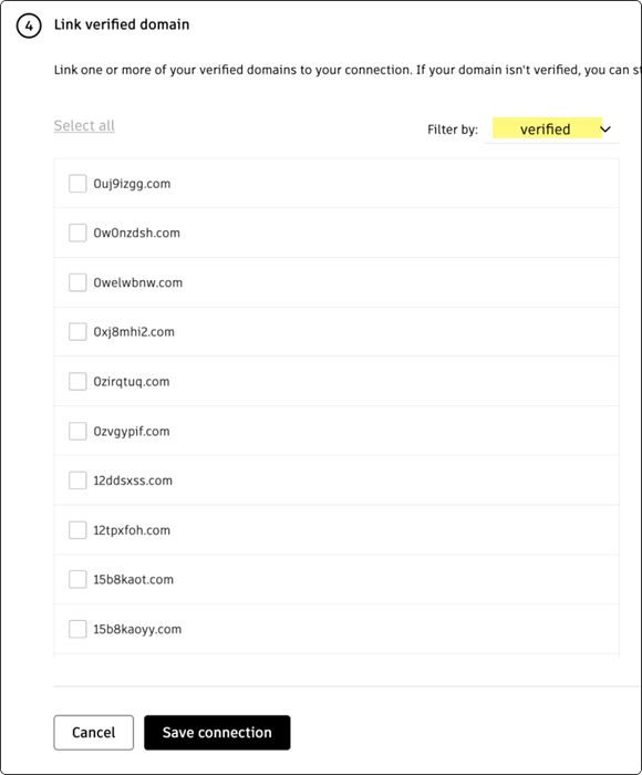

You will see a list of your verified domains. Select one or more verified domains to link to your connection.
Click Save connection to complete the setup.
