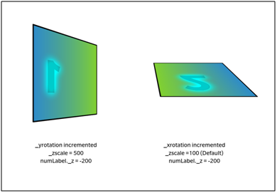

Figure 1: Example of back-facing numbers which are not culled or drawn behind
